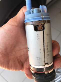

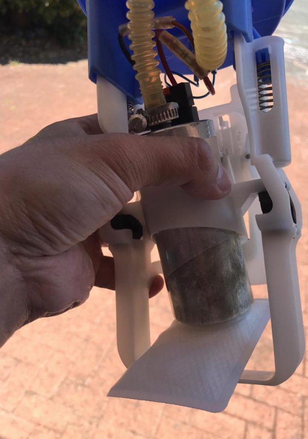

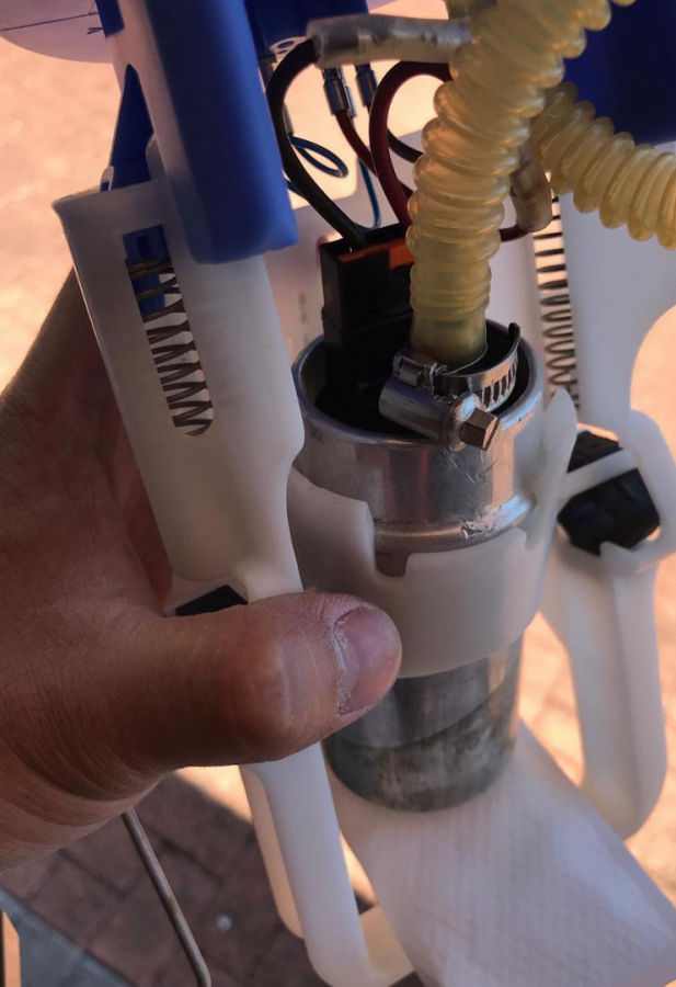

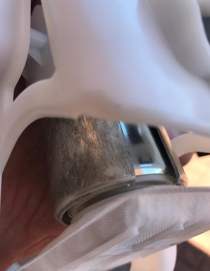

      You can fit a 255lph walbro. Get an installation kit and sleeve with it.
        Saw this on another post. The owner used the old fuel pump exterior as a sleeve for the replacement pump.

          Did the same thing on an E60 M5 fuel pump, worked great. I bought an M3 pump years ago for when mine goes bad but would definitely consider just putting the walbro in. My M6 will be getting the walbro for sure when it's time.
            Is the Walbro good? My cars hitting 20 years old and wanted to refresh the fuel pump for maintenance as it nears 120k.
              Yes, no issues, quiet. I reused the sleeve too from the old pump but too much work if an install kit is available.

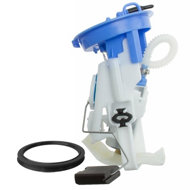

                Hella fuel pumps on bimmerworld.
                Replacement fuel pump to restore proper fuel system operation. Replaces BMW part # 16142229684.
                  I bought the Hella branded pump, no idea if it's a rebranded china pump but it solved my 2nd crank issue that I lived with for years.
                  The quality of plastic seemed the same as the original pump I pulled out just shiny new.

                    Same with me. Been running well for a few months now. $99 bucks hard to pass up even as an experiment!
                    the fuel level sender electronics seemed to be different than OE but so far it works great. Also, comparing to a 21 year old pump… so you never know the OE pump could have received the same revisions.

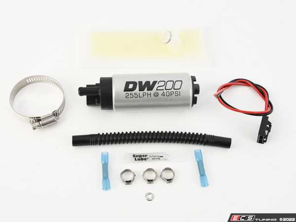

                      Any reason to consider the Walbro at twice the price just for the pump itself? Also, I'm guessing the lack of check valve is irrelevant because of the automatic priming?
                      How about the Deatschwerks - I guess 255 is stock equivalent? Never heard of them, and the Hella seems like a better deal and simpler RE/RE with less time for fuel vapors to soak into the interior while changing.

                          I'm using the DW in the stock housing now solely to avoid a "fake" Walbro.
