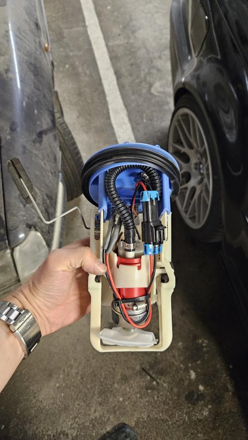

    Fitted a Walbro with a sleeve to my car as preventative maintenance recently, but I now need 2 start attempts as it will just turn on the starter on the first attempt after sitting for a while. It'll always start right up on the 2nd attempt no matter how long I turned it on the first. I imagine there's no check valve with the Walbro and the pressure drops whilst it sits, I don't get the feeling there's an automatic priming process so I'm tempted to get the fuel pump assembly out again and fit an external check valve just after the pump.

              Did you replace the PTFE hose? Radium has them separately and with their sleeve:
              They get hard from living submerged in fuel and, having been stretched to fit the original pump's barb, don't seal properly on the new pump even with a clamp. I'm not sure how it works exactly, but I suspect what's going on is the fuel system leaks down around the barb between starts and then can't refill properly until a start attempt has been made. Maybe the injectors need to run before a prime can refill the rail? Whatever - it fixes it.
              Also, counterfeit Walbros from eBay often don't come with a check valve. Get the real one:
              RADIUM DOES NOT OFFER A WARRANTY ON ANY FUEL PUMPS! Warranty claims must be administered by the pump manufacturer. Fuel pumps can be returned in unused condition within 30 days of the purchase date. See terms and conditions for more information. The classic "Walbro 255" EFI fuel pump is a great options for any vehicle
              Edit: I found a heat gun essential for installing the new hose, but it's also easy to melt the plastic, so use low heat intermittently while turning the hose. Done right, it slides right on and then cools onto the barb.

                It looks like the OEM hose, no PTFE but it's definitely lacking a check valve so I'm strongly considering revisiting this. I didn't buy the pump on e-bay, I found a kit somewhere on a website, I forget which..

                  I was wrong - they're actually just nylon. Here's the tube separately:
                  This tubing is found in many Radium fuel system products. It is designed specifically to handle gasoline, alcohol fuels (including E85), and diesel fuel in fully immersed, mobile, stationary, and marine applications. This is engineered for constant contact with liquid petroleum distillates on the inside and outside of
                  Not familiar with that kit or source for the pump. I guess you'd have to get in there again and see if it has a check valve.
                  My experience was that I started by putting an eBay Walbro in both of my E46 M3s and had your identical symptoms, and then I swapped one car to a genuine pump from Radium and it didn't fix my issue. I lived with it like that for a long time and hated it, but eventually tried a new hose for it and it solved it immediately.
                  On the second car I tried a new hose but the with eBay pump, and that didn't solve it until I also got a genuine pump for that car as well, so I'm pretty sure you need both a check valve and a good barb seal. It felt so good to have it fixed after years of living with it every day.
