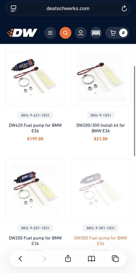

                          I've got a Deatschwerks DW300 ready to swap into my Hella housing, just waiting for a hose to arrive (Radium install kit seems to include the wrong size hose) Tried buying used pumps locally for the housing but I got nowhere with that so will have to use the Hella.

                            Are you FI or NA? As far as I see the DW200 should be enough for NA on our cars.
                              #44
                              NA, I just followed the compatible pump list on the kit and it was the only DW pump shown.
                                #45
                                this is what it shows me when I put in a 2004 M3. The 200 should be ok for us NA folks with a tune.
