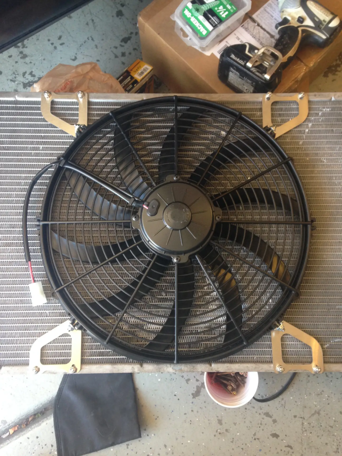

            The cooling setup that I have that makes life easy, simple, and clean...
            Koyo Radiator
            SPAL Electric Fan 30102082 (w/oem pusher fan)
            N15 Mount Kit
            Mishimoto Adjustable Fan Controller w/ 1/8" NPT Radiator Probe (plug & play into Koyo rad)

                  hey. i'm in the process of doing a cooling refresh. did a 3 day track weekend here in NJ (NJMP) and temps were @ 100 and coolant stayed @ 210. had to do cool down every 3-4 laps cuz it wouldn't keep up.
                  regardless, i see your auto cool fan controller and i ilke it but curious, any reason why the derale PWM controller wouldn't be just as good. it has a flush mount temp probe thats PnP. not saying one is better than the other. just honestly uninformed so looking to see what i'm not seeing. or did you go w temp probe for something more accurate? thanks.

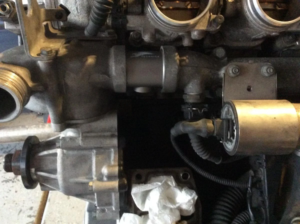

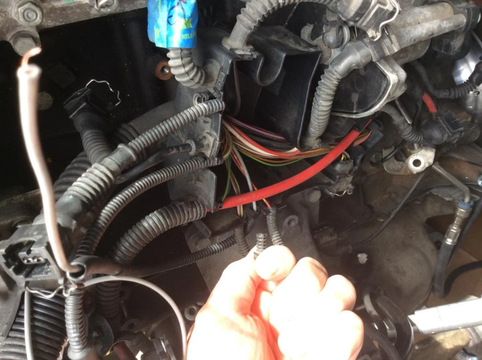

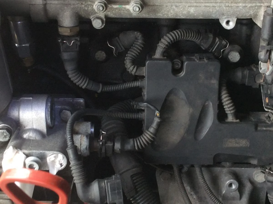

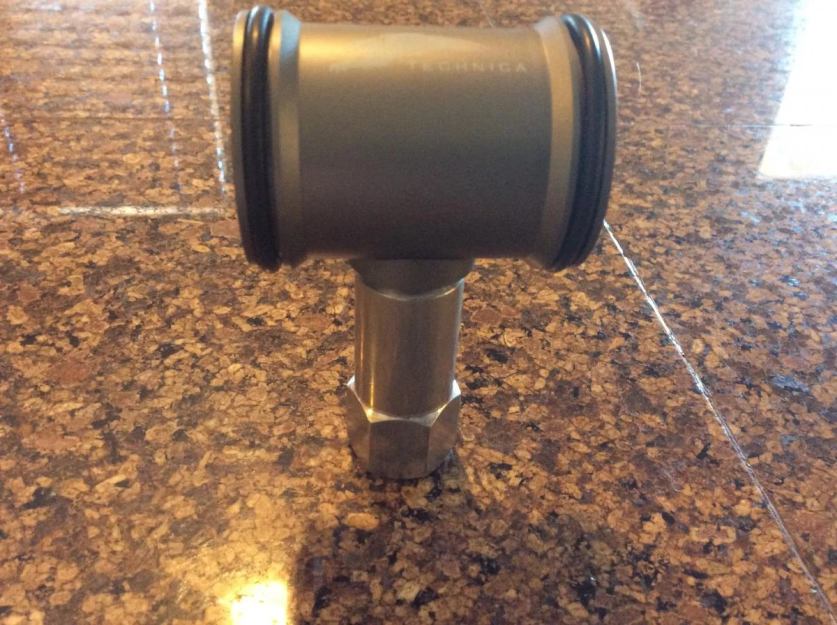

                    Here is my take, I believe this is the best solution. Better than the N15 design, which I ultimately threw away. I used a Technica Cooling pipe, with a thermoswitch. I then wired it through the oem loom, back to the ecu compartment where I mounted the relay. The mounts are from a not so well known company. Called Massivebrakes.com, they make top tier stuff. Enjoy!

                      I'd make sure the switch is grounded. That pipe won't have a good ground since there are rubber o-rings which electrically isolate the pipe. Stupid ass VAC makes a pipe like that and didn't know that when I called them about an intermittent coolant temp reading.
                        #56
                        I'm not sure what you are talking about? This sensor reads the temp and that goes to the relay, which controls the fan. I've had zero issues with it, its lighter than almost every other setup. I was able to depin and delete all the oe wiring. idk?

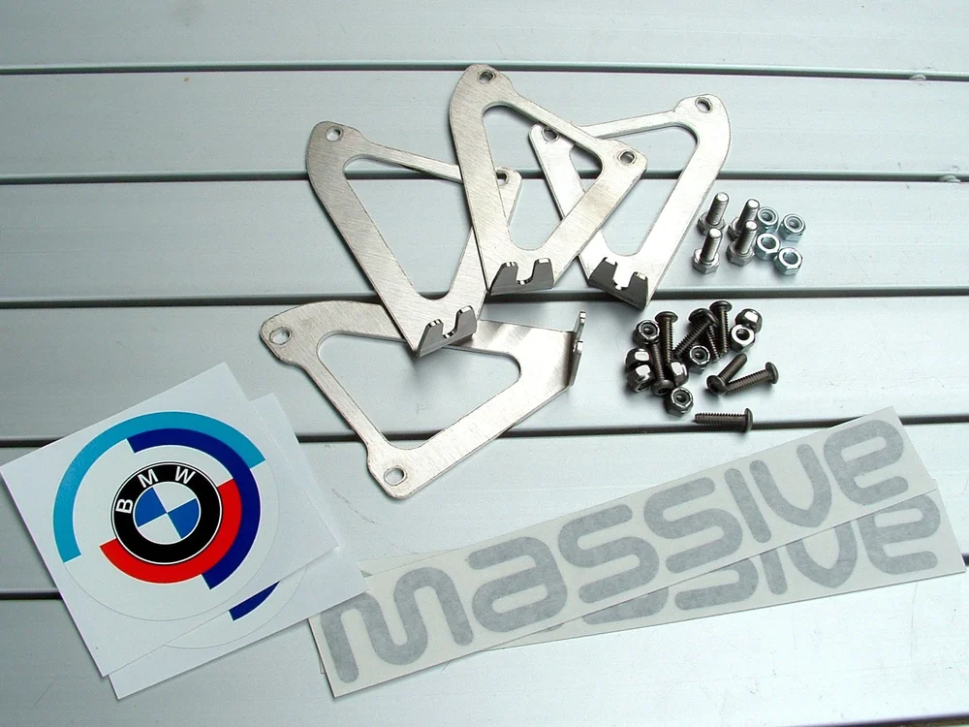

                          educate me here. how are the massivebrakes brackets better than the n15 brackets? i mean it's cheaper so that's a good thing but is it more just an alternative solution or did you see a flaw? thanks for the help.

                            If it is a two wire sender then no issue. Some senders are 1 wire which you would need to ground the sensor to the engine. I used a crimp ring as a washer on the sender, ran a small wire to the t-stat housing bolt and grounded the wire there.
                              #59
                              Are you saying, before you grounded the sensor. You were experiencing a situation where the fan wasn't kicking on at the correct temp?
                                #60
                                He's saying that one wire sensors use the sensor body as ground and when that is screwed into something like the coolant tube (as yours is) the o-rings will sometimes provide enough insulation that the electrical ground will not be complete. This could result in the sensor working inconsistently or not at all. If that is the case I adding a wire from the sensor body to ground usually solves that, but using a 2 wire sensor with a dedicated ground wire will also work.
