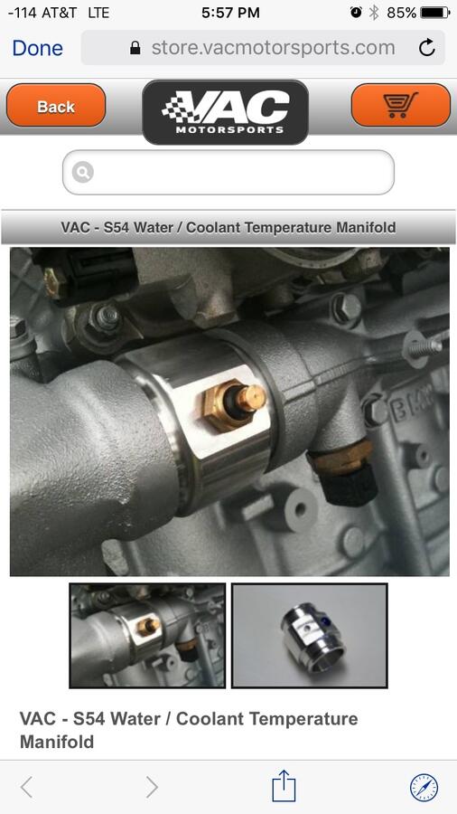

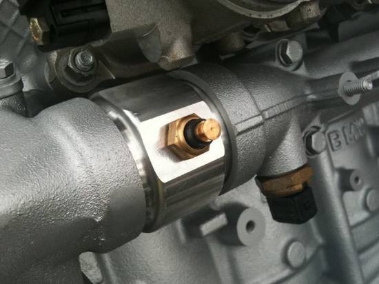

    The VAC Motorsports Water/Coolant Temperature Manifold for BMW S54 engines, E46 M3, allows for the easy install of water temp gauges.

      Originally posted by S14 View Post
      Heads up, VAC sells a pipe with a sensor bung that replaces the pipe between the thermostat and the elbow that bolts to the head. It's a tidy way to add a water temp probe.
      Thanks! I do quite like the way this fits in and is perfect since I already have the 1/8'' sensor.
        #33
        The AutoCool Guy does not recommend using the VAC coupler because it measure the hot side of the coolant. As a result, the fan will always be on. I now use it for my water pressure sensor with my AIM system. I used the following 40mm coupler for the temperature probe from AutoCool Guy. It fit perfectly in my Bimmerworld lower radiator hoses.
        Thank you to WOLFN8TR for introducing me to AutoCool Guy's solution. I think it is the best solution available since the OEM AUX fan box have instance of failing in high heat track conditions. The scariest part was checking that the temperature knob was properly set to turn on when the coolant reached near 80°C. Had to have INPA running to verify. LOL.

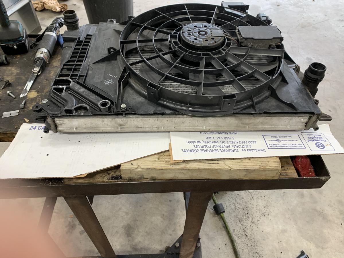

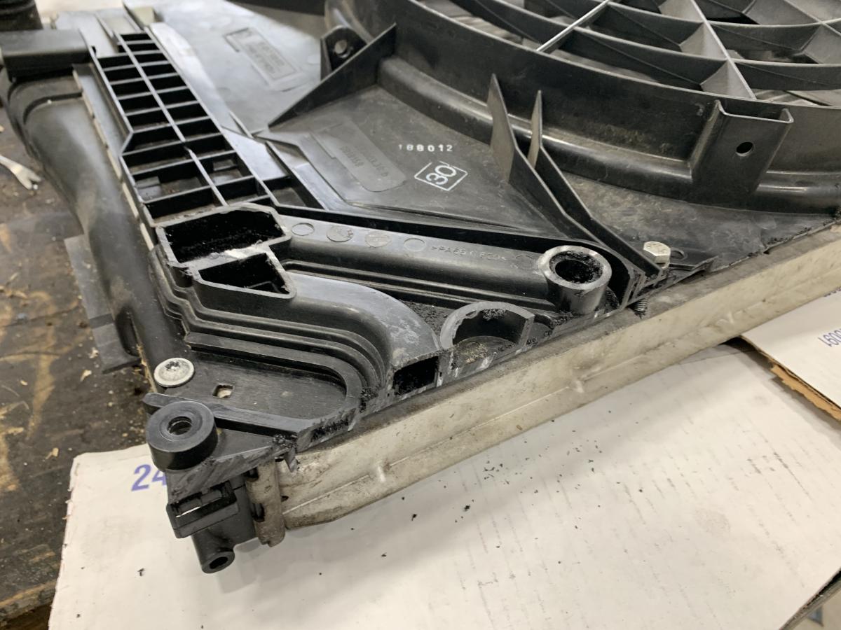

                          EDIT: I assume the PWM is not available separately? It is too bad one has to cut it off a $750 factory part, I guess it's only 2 wires cut at the end of the day they could go back.
                          Cut if off the front fan when you remove it.
                          See pic:

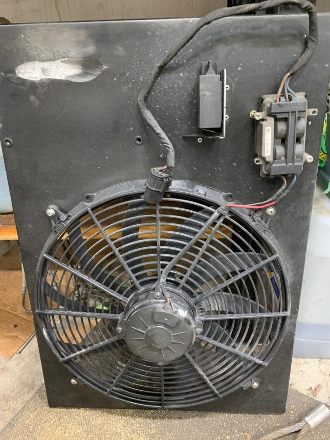

                          Email to [email protected]
                            #43
                            Here's an E39 setup I put together awhile back, it's using a zionsville shroud, SPAL fan and factory fan controller.
