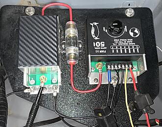

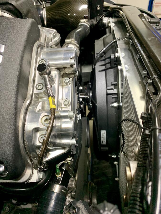

    Here ya go. Disregard the buzz box on the left, the newer version has it built in. Let me know if you have any questions.

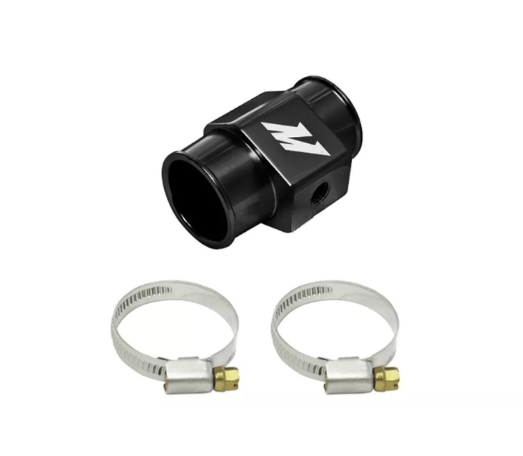

        Installed a radiator hose adapter for the temp sensor.

          Looks good. Did you just go with the Mishimoto for appearance over the copper one on Auto Cools website? Also, I assume you're just using the 1/8'' NPT sensor listed on his website?

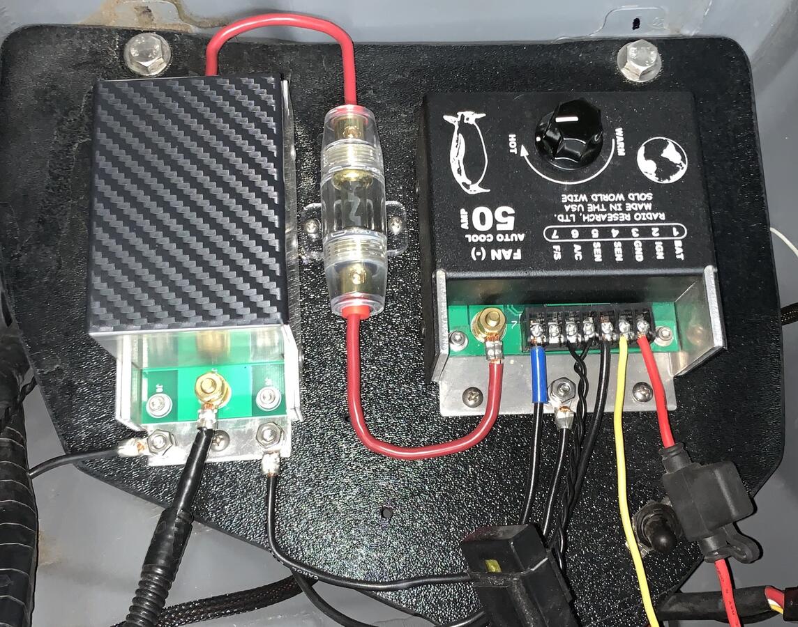

            You can wire it to the Aux fan control if you remove the Aux fan otherwise you will need a separate fan control. I use a PWM unit which operates similar to the Aux fan control, variable speed.

            any downside to skipping this module and just wiring to the old AUX fan box?

                Also, what size adapter is that?
                  1/8" NPT sensor from AutoCoolGuy. I already had the Mishimoto adapter is all.

                  Any downside to skipping this module and just wiring to the old AUX fan box?
                  No that will work great. I went with a PWM unit as I'm running both the Aux Fan and the Spal do to the 120 degree summer heat.

                  Spal makes quality fans, both brushed and brushless. The 2082 is a brushed fan.

                  I do believe it's a 38mm.

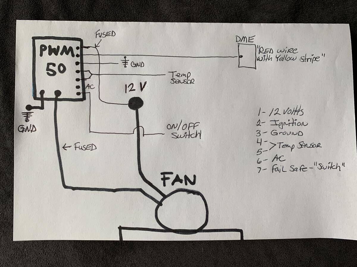

                            How are you guys wiring these up? I almost did this then got concerned with the fan running properly to keep the temps down.
                            Can anyone provide documents on how they wired it up?

                              I found this for a basic overview. Using this controller anyways.
