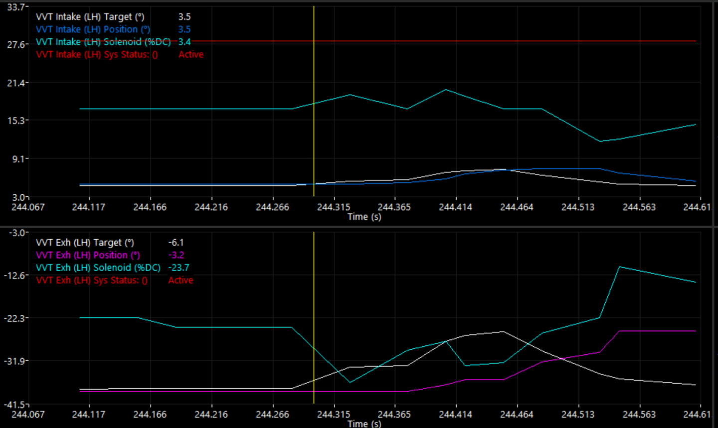

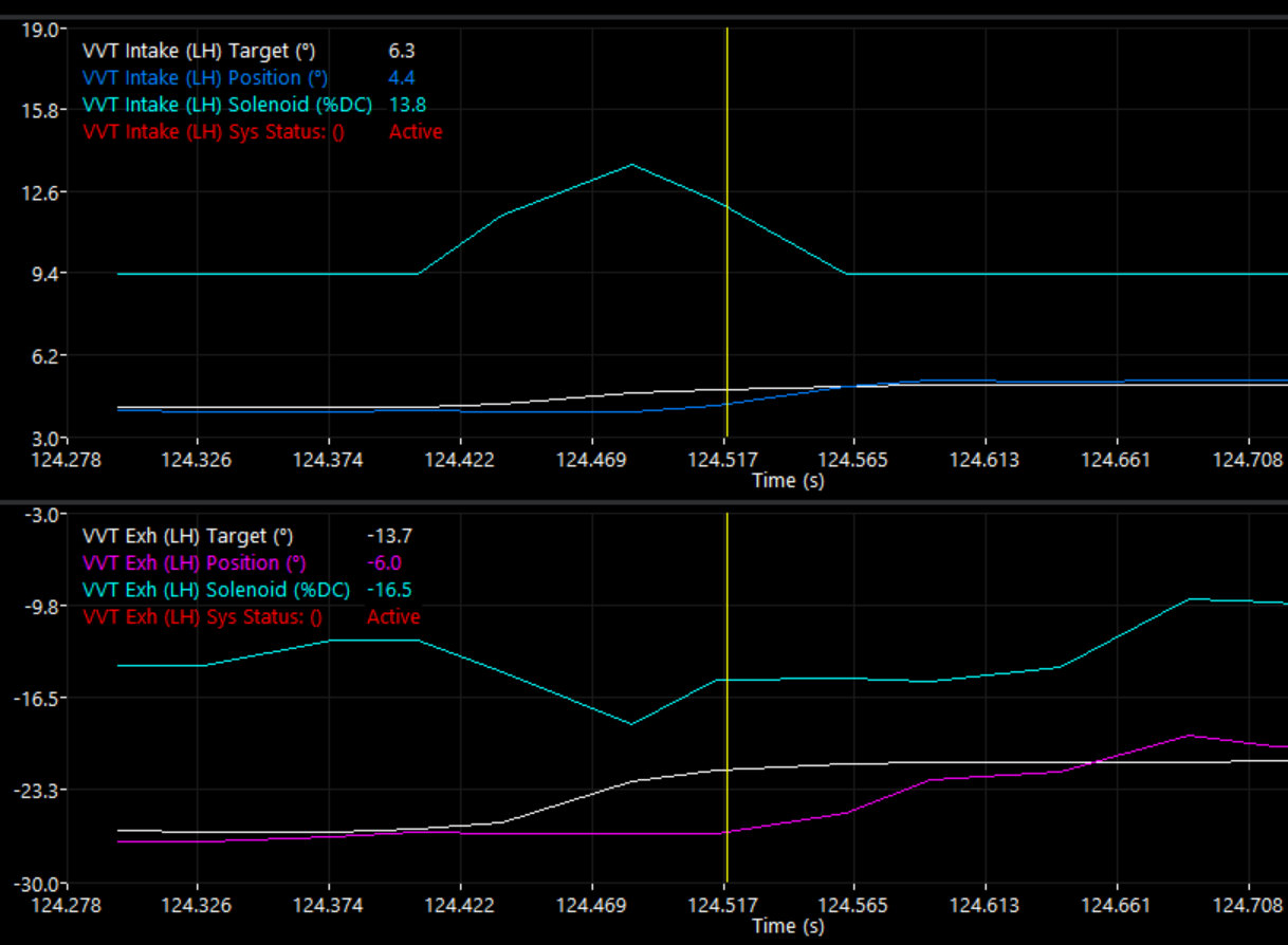

                        I ran both S54 and S62 springs and didn't notice any reduction in response time from my vanos. I'm not running a stock computer but the closed loop control settings were not adjusted between the installation of the S62 springs. Oil temps at 90-92C on both screenshots. ~100ms response from position demand changing to the cams beginning to move.
Name:	S54 springs.png
Name:	S62 springs.png
                            That is latency, isn’t it? Springs would have no influence on that. You need to log the time it takes to get from current position to a new position, DIS does this as part of the VANOS test and rasures the time from most regard to most advance, smaller adjustments will obviously take less. It has been documented the S62 items delay the system.
