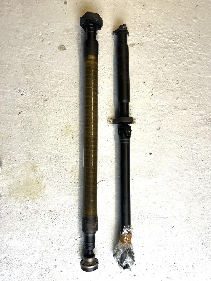

      Installation was easy, i have SMG car, no problems with clearance. I am running original heat shields, did only slight adjustment of the shield on one place so it doesn’t make contact. Installed with new guibo and CV joint.
      BUT there may be slight vibration in mine. Starting at 130kmh and it stopped around 150-160kmh. The guy in the shop told me that he balanced it at 3500rpm. That it’s the max rpm he could do, not sure if it’s enough or the problem is elsewhere. Its not very noticeable, but i guess i will have adress that.
      What RPM the driveshaft has at top speed?
      Weight of the original driveshaft without guibo and bolts was 8,21kg compared to M4 with guibo and bolts 7,38kg. Not sure how much guibo with bolts can weight, I would guess around 400-500g. Somebody can measure it. So it would total around 15% weight loss, 1,2kg/2,64lbs.
      I sourced used shaft for 200€ and had it adapted and balanced for 300€. Plus new guibo 60€ and CV joint 200€.

          I already sent this to a couple of people via PM, figured I would post it here in case others are interested in the future:
          I did not do the actual welding, so I can't comment on that, the rest was fairly simple.
          I bought the M4 driveshaft and a 330 driveshaft as donor for the flanches. Make sure you buy a 330 shaft that has the same end links as the M3. There are some weird different shaft variants out there for x drive or automatics.
          I measured the OEM M3 driveshaft length in two dimensions: with the rear joint compressed and with the rear joint stretched and gave that Info to the welding company. They then mated the flanches to the m4 driveshaft and balanced it.
          My measurements were:
          1364 mm with joint compressed
          1376 mm with join stretched
          Installation was straightforward. The shaft is a bit thicker than the OEM steel pieces, but everything cleared fine. I did not have to do any changes to other parts. You will have to loosen your diff mounts to push it back and mate it to the shaft.
          Unfortunately I did not weigh the part when I got it. The M4 shaft weighs 7,6 kg. it did feel considerably lighter with the E46 flanches on it (I would guess 5kg)​
          Also make sure to install a new ball joint and dont reuse one from some 330 shaft you buy used. It is BMW part 26117841003.
