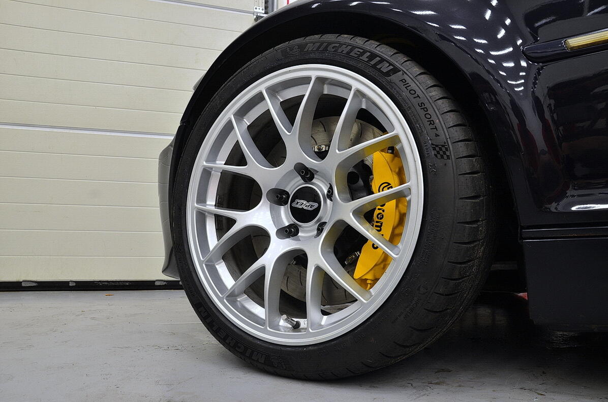

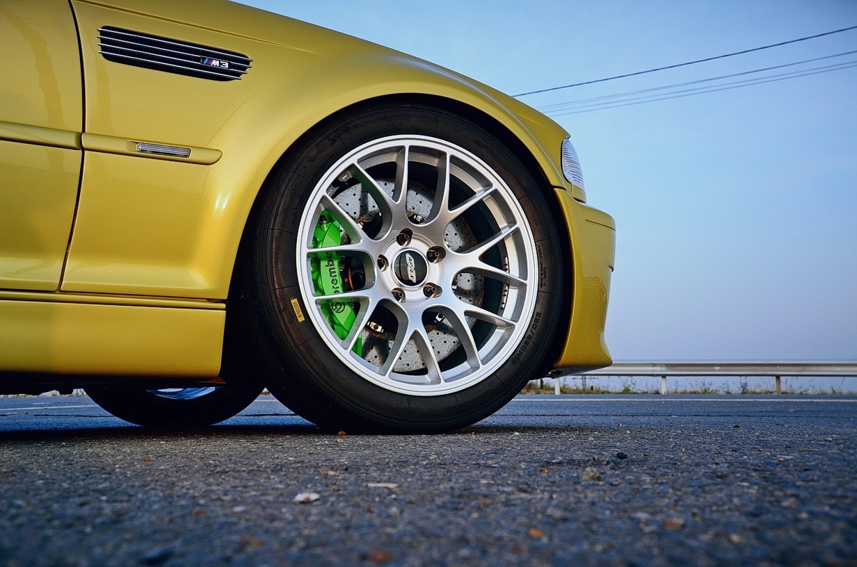

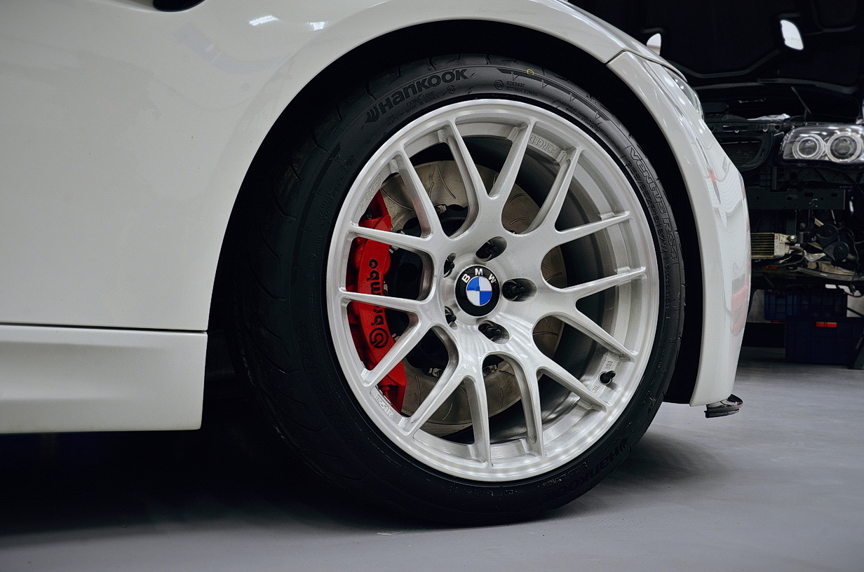

            Apex EC7 R18 wheels accept even 390mm brake rotors with good enough clearance due to their flat inner. 380mm fits with a LOT of clearance into them.
            390mm on pic

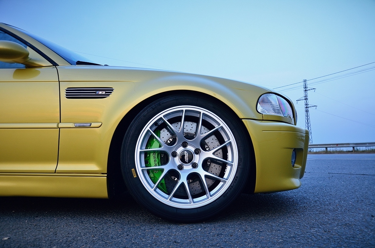

            380mm

            there are quite a lot R18 models with the flat inner these days, due to the modern cars with the large brakes, like BMW M models (f8x) for example, where minimal brake diameter 380mm, and a lot of people, who prefer to use R18 wheels.
            BMW offer even oem R18 rims (forged if i'm correct), which fits on 380mm - 513M style.

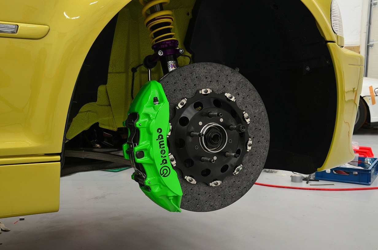

              Carbon ceramics? Nice!
