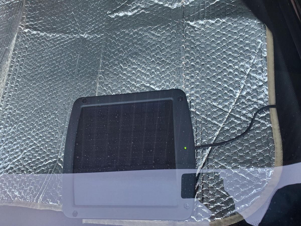

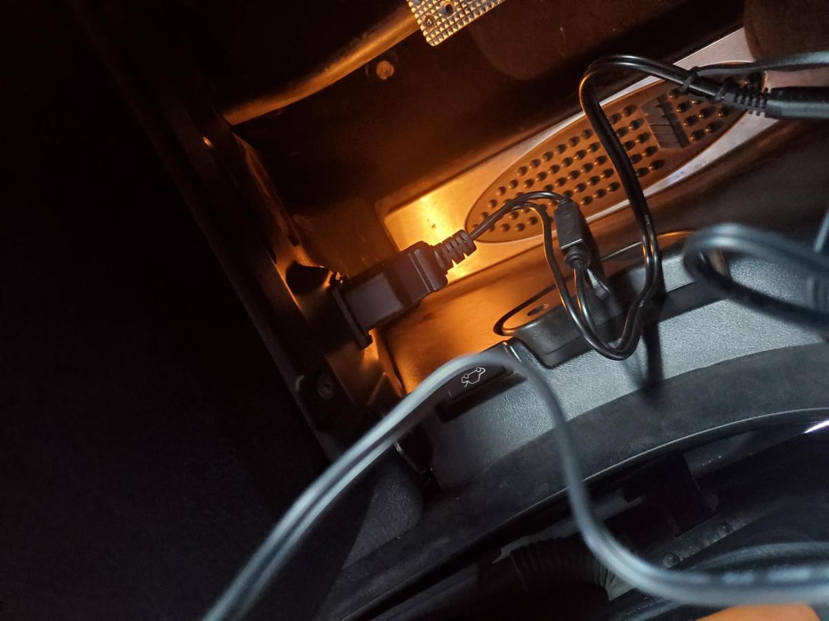

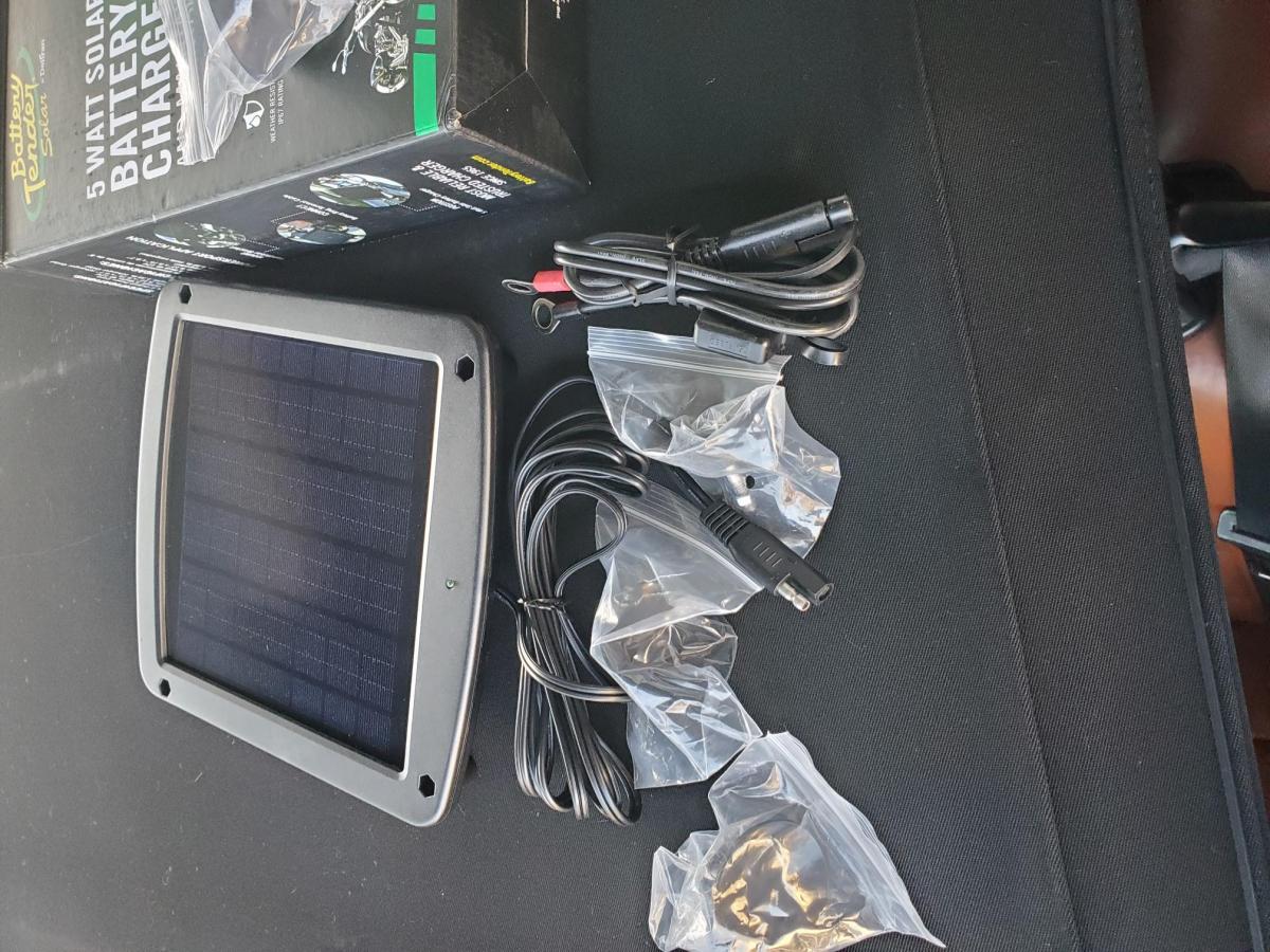

                  Sort of related, my car sits outside for long periods of time but no outlet nearby. Picked this up recently and it's been pretty solid.
                      ​​ Click image for larger version  Name:	20231225_151848.jpg Views:	23 Size:	137.9 KB ID:	246910 Click image for larger version  Name:	20231225_152103.jpg Views:	24 Size:	174.4 KB ID:	246911 Click image for larger version  Name:	20231225_152637.jpg Views:	23 Size:	89.5 KB ID:	246912 Click image for larger version  Name:	20231225_152655.jpg Views:	22 Size:	239.5 KB ID:	246913
                      Great idea - I have a car that sits outside and this seems perfect for that. Unfortunately, there's one on sale right now with the cigarette lighter option for about 45% off, but it's sold out

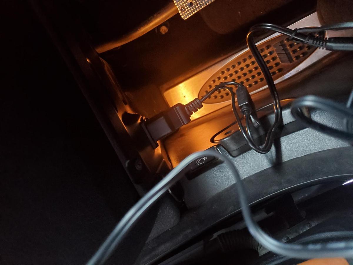

                              The green light blinking, this could be a point of reference:
