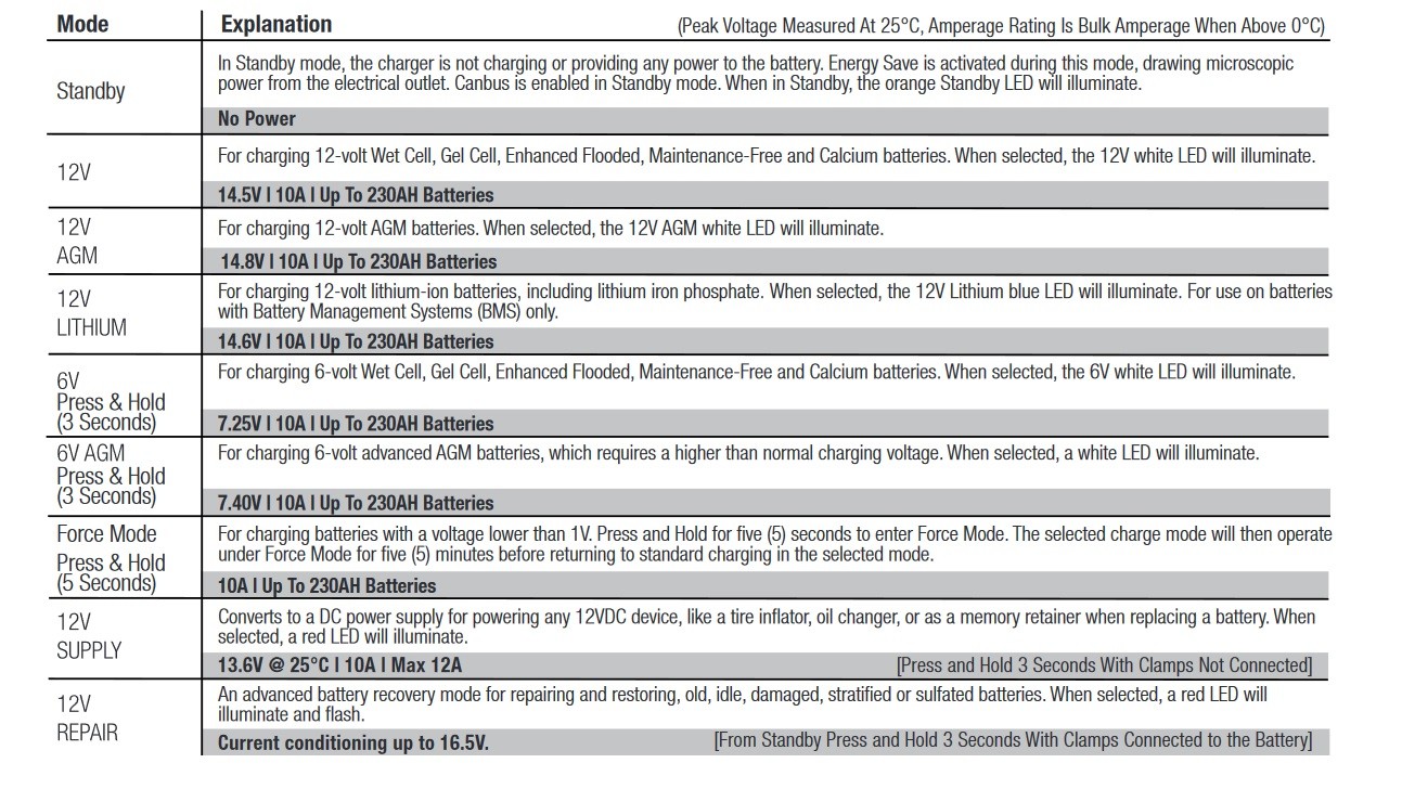

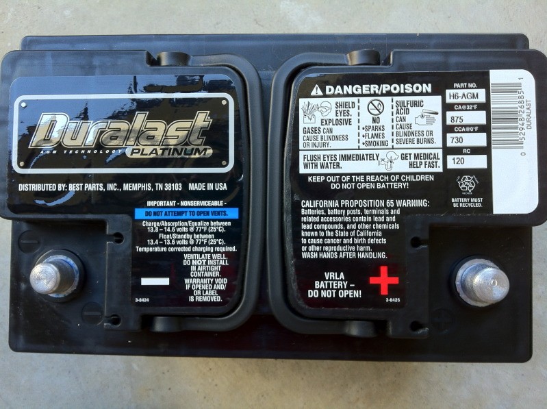

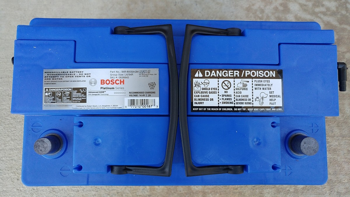

        A note of caution on the Noco Genius 10 charger - Make sure your AGM battery can take a charging voltage up to 14.8V! The Noco charger will charge your battery up to 14.8V in AGM mode! Most AGM batteries have warning labels about maximum charging voltage at no more than 14.4V. Attached are a couple of pictures of my past AGM batteries - an H6 and H7. Also attached is a clip from the Genius10 user's manual.
