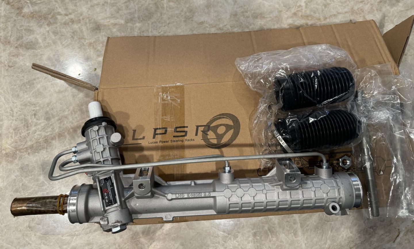

                Bought Lucas Black Label 2.5 turn rack, let's see how it goes. Thanks Everyone! Will post some pics once I receive and after installation.
                  Finally got the Lucas Black Label 2.5 turn rack today.

                            Got busy with other life priorities and was not able to install it, would be doing it in few days. Is there any good DIY for this? I see 50's kid one but he does not talk about how to keep it centered. I guess we have to keep the steering locked while working on it and measure the tie rods to the rotors?

                                Center the steering wheel then lock it with the key out of the ignition. Then just make sure the stick out of the rack gear from the steering housing body is the same on both sides when you attach it to the steering column. You will then attach the tie rods after the rack is attached to the subframe.
                                If you are changing from CHF to ATF, I would get a new reservoir. It has an integrated filter and it makes sense to replace it.
