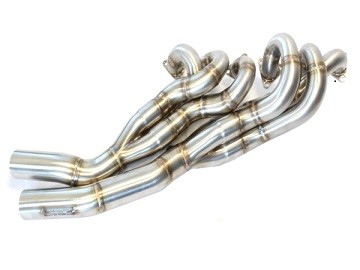

BMW Motorsport Inconel S54 Headers
You're welcome to Google "Fetcher made horsepower" call and ask him yourself. He has engine dyno'd these and they have no low end torque they're designed for an all out race engine. No I don't and don't know anyone who who would have the graph but just words he's provided. For reference he was PTG's tuner for their racecars

There were three cam options for the P54 - 316° or 304° intake and 298° exhaust. The engine lives at high RPM all the time and can take advantage of those headers. The routing is very similar to the discontinued Epic headers which were not very popular -
Someone said that the installation required removing the passenger side engine bracket. It appears the manufacture chose to make them without the V-band. The V-band probably made the P54 headers easier to install than the Epic headers.
There is really no good reason to have either of these over the SSV1s on a non-race car.Last edited by Slideways; 01-09-2024, 02:20 PM.
- Likes 1
These are in the parts catalogue for the Z4 VLN car equipped with a P54B32.
These cars are also running a 316° intake cam. Not interesting for any application that is less than 100% race...
Although the design is true equal length between both banks, which makes it kind of intriguing...

There is someone in Michigan or near the Great lakes that makes duplicates of these for 1/4 of the price.
- Likes 1
Instead on getting these or a replica, there's still the Achilles headers as an option. They are also true equal length, so they should provide a similar sound. As a plus for street friendly builds they do have a step in them.
I have searched for sound videos several times, unfortunately I didn't find any.
Interested to hear who's doing that if you know! Did a bit of searching around but couldn't find anything.Originally posted by Cronenberged View Post
Especially in the impractical car you're considering 😜
I contacted Achilles about these, they actually have a fab shop local to them build the headers. He told me the car needs to be brought to the shop and the headers are custom-fabbed to the car, including the rest of the exhaust system if needed etc. They didn't seem to have an off-the-shelf option available. I'm still considering it as I don't think the design of the SSV1s I have now are all that great, plus as mentioned they are not fully equal length.Originally posted by Altaran View PostInstead on getting these or a replica, there's still the Achilles headers as an option. They are also true equal length, so they should provide a similar sound. As a plus for street friendly builds they do have a step in them.
- Likes 3
Yeah, I talked to them about it as well. Since I don't live stateside anymore it's not an option for me.Originally posted by BBRTuning View PostI contacted Achilles about these, they actually have a fab shop local to them build the headers. He told me the car needs to be brought to the shop and the headers are custom-fabbed to the car, including the rest of the exhaust system if needed etc. They didn't seem to have an off-the-shelf option available. I'm still considering it as I don't think the design of the SSV1s I have now are all that great, plus as mentioned they are not fully equal length.
On the bright side: being custom fabbed, they can make em to fit your SS V1 Section 1 connections.
The only other name that pops my head for true equal length headers is Kromer Kraft. But I don't know if they are still around...
