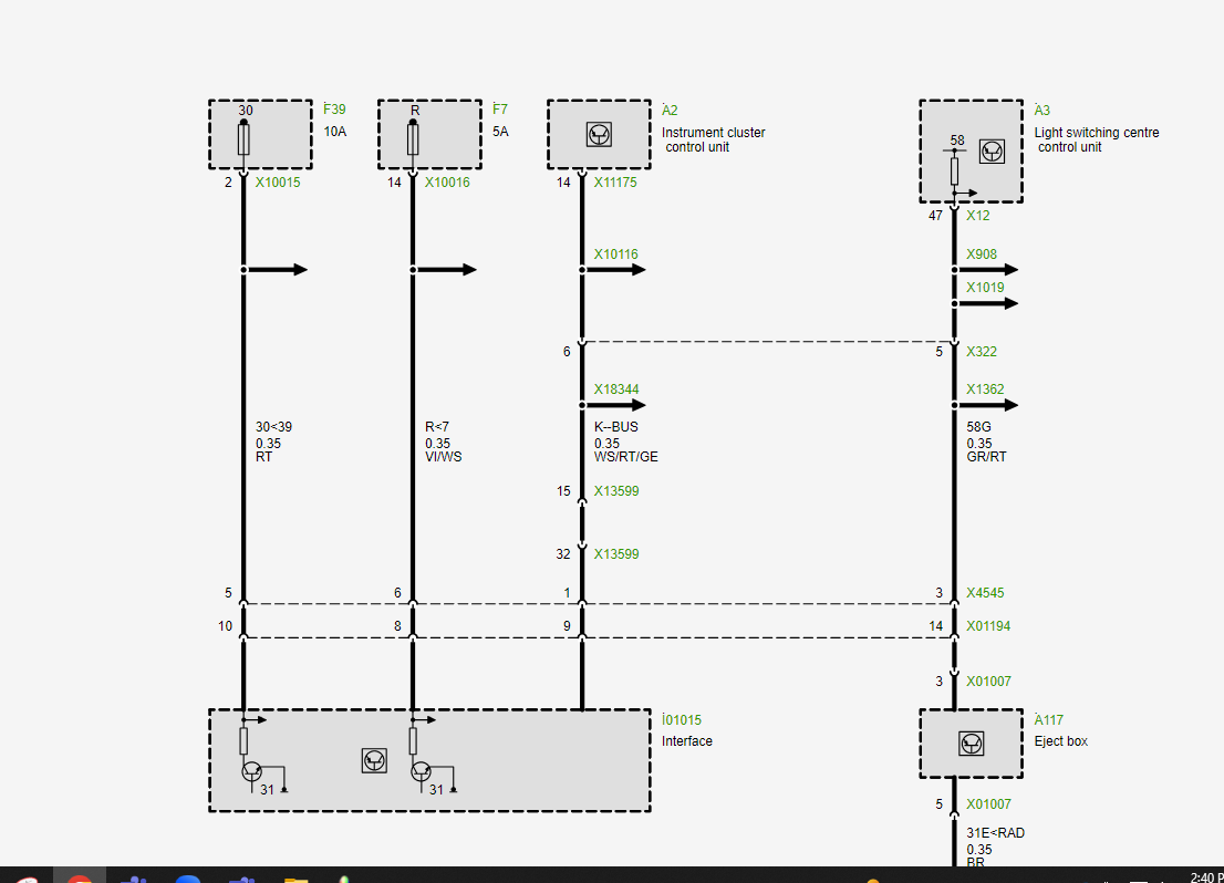

            Pin6 and 8 are 12v from 5A fuse for telephone supply, so this should be more than enough for 10w USB port. Note: this circuit below is only for cars from 2002/3.
            Quote "edit: One important factor is it needs about 10W of power, which some cheap USB adapters cannot provide."
            OP, I would wire up the current USB adapter to the said pin6 of the 18pin phone connector, then hide the usb bulky adapter under the console and run the usb output cable up the dash to your device.

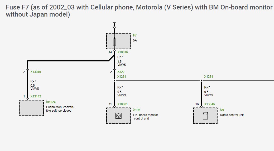

                        The original circuit is to power the phone at up to 60 watts (14v x 4A), so I feel it’s perfectly safe to power the usb adapter directly without additional relay. Worst can happen is the 5a fuse blows by bad devices or damaged adapter then just correct the problem and replace the fuse.

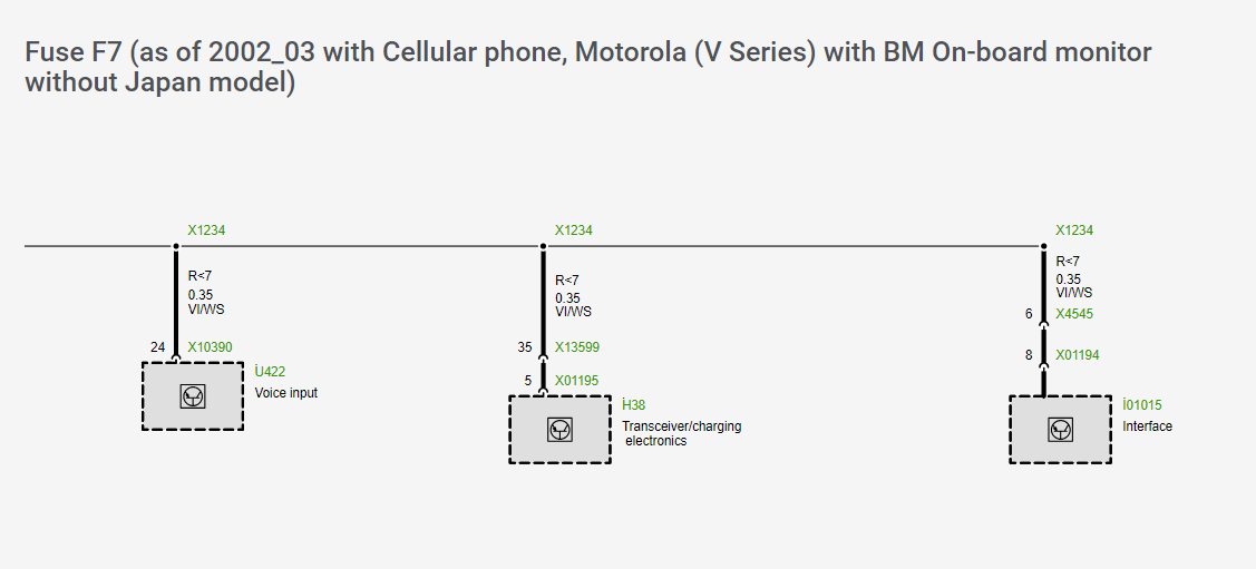

                          What other devices are connected to the 5a fuse circuit? Is that fuse in the glove box with all the others?
                            these are the devices that connected to F7 and all of them are lower power input control interface:

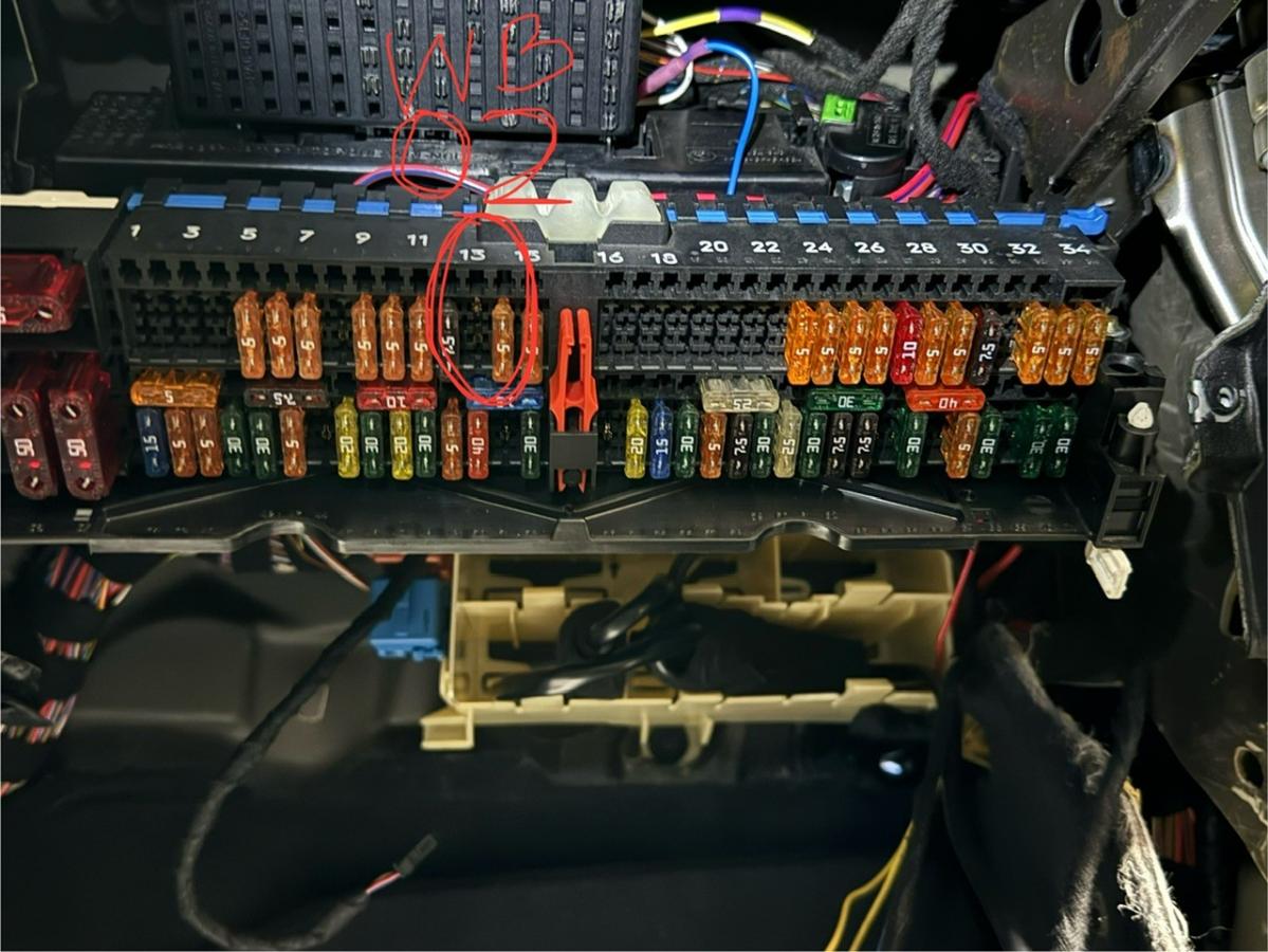

                              Yeah 10W is <1A. I run that fuse/wire directly to my 15W phone charger, the 5A fuse has never popped. If you’re running wires and you want a dedicated fuse, don’t tap in to an existing fused wire, just install a receptacle in an unused fuse location (like fuse 13, used only in cabrios) with whatever size wire and fuse you need.
