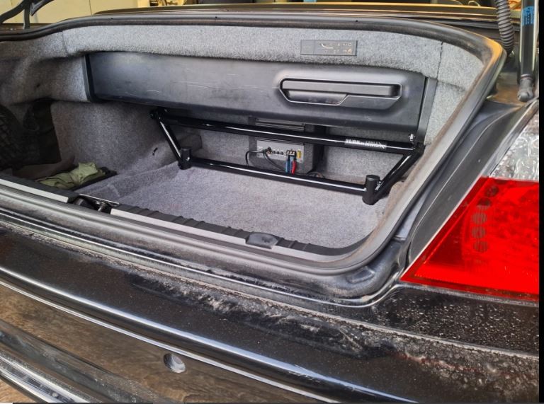

                      I'm actually not going to use any of their top side plates, I have opted for a 6-point Yurkan Cages brace.

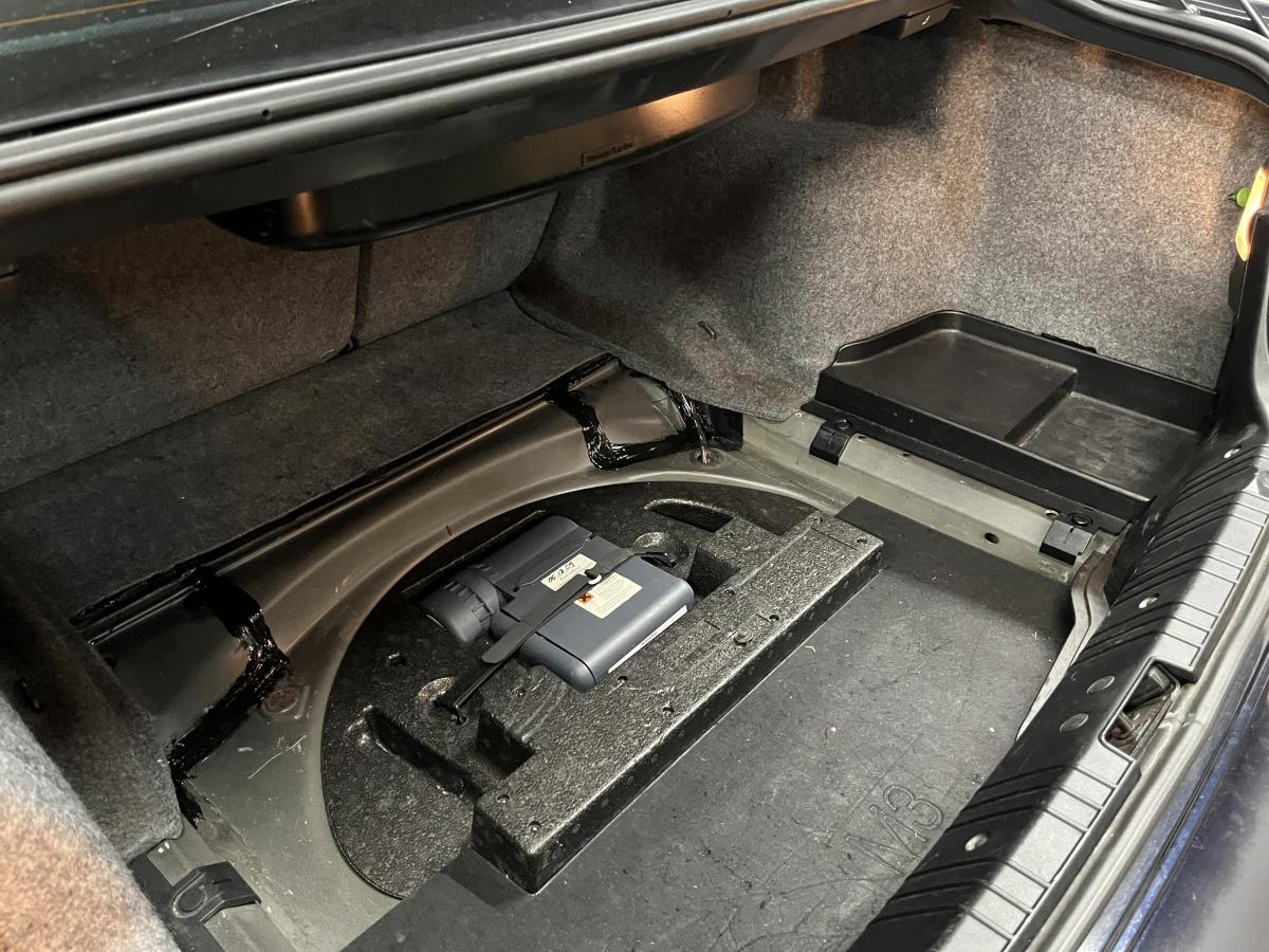

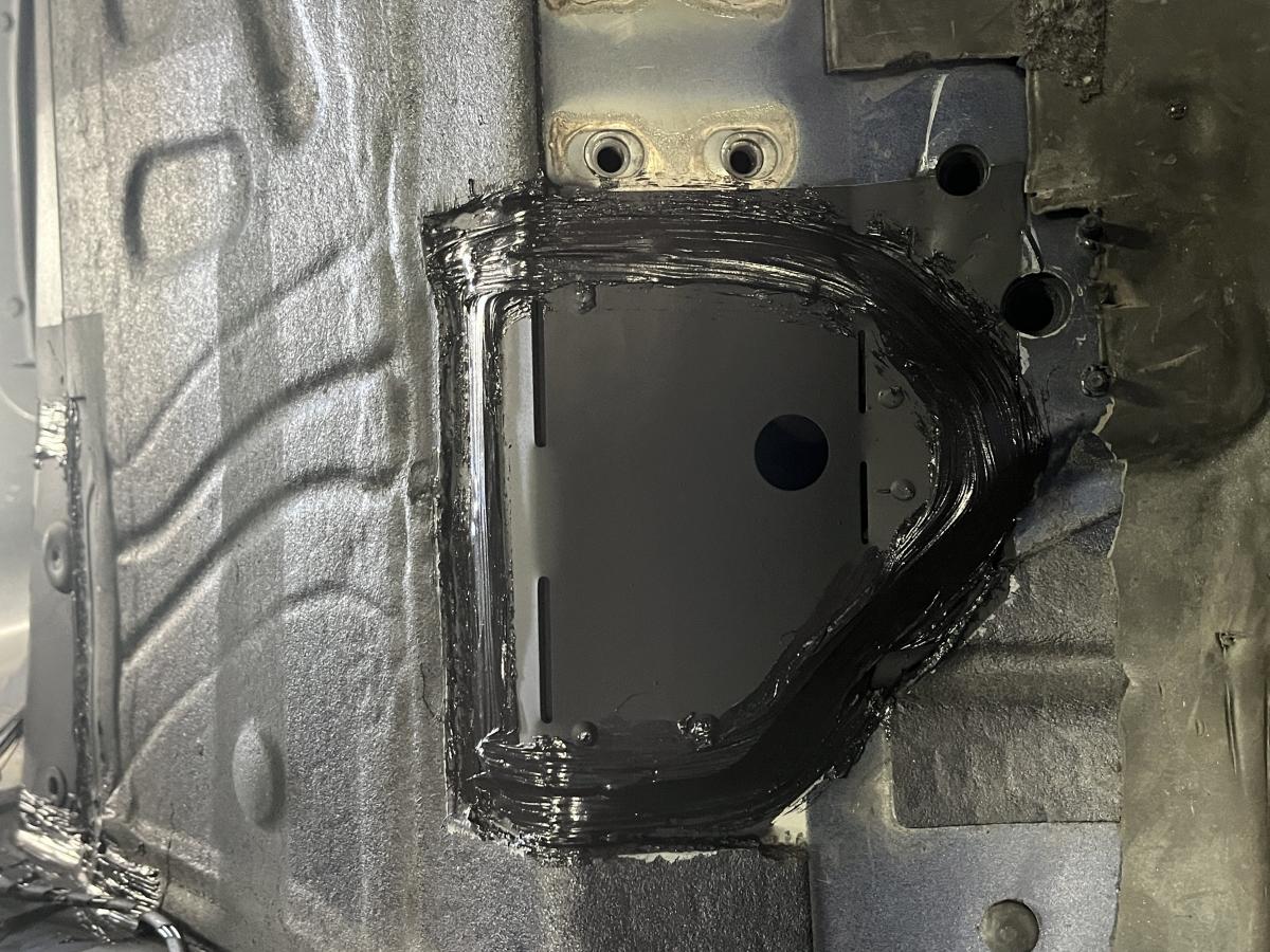

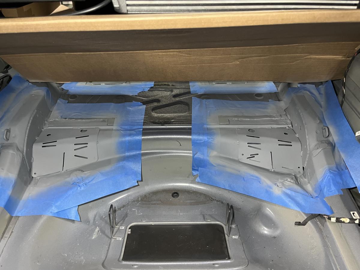

                        I just did the CMP brace on the front, and the DMG RACP in the rear.
                        No idea what's the "best", but the instructions for the CMP brace are awfully thorough.

                          9kracing - This is pretty cool! Question: for the DMG brace, did you do any topside beams (welded/epoxy) or just the brace itself?
                          Nate047 - You're a Champion man, I've never heard of Yurkan before. So no topside beam for you either, just the point brace? Did a quick search and he just released one of these a few weeks ago:

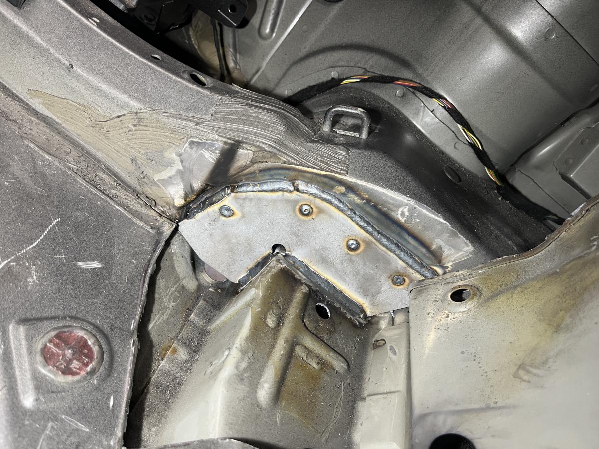

                            I've done both Reddish V3 and several Vincebars. My opinion as an installer is that they are both great solutions (and from great people!) but the amount of prepping, cutting, welding, finishing etc is fairly substantial. And take this with a grain of salt as I'm no engineer but I do wonder if there could be downsides to the sheer amount of welding involved (heat/fatigue?). No comebacks or issues though FWIW.
                            I like a somewhat simpler and less intrusive solution. My go to is AKG lower plates which are beefy and offer a good foot print + CMP stage 1.5 chassis rail plates (more or less the same thing as the Reddish V3 uppers or a Vincebar "light" you could say).

                            CMP: "stage 1.5 chassis rail" reinforcement. I just basically cut open a "lid", weld the reinforcement, then fold the "lid" back into place, tack in a few spots and done.
                            Click image for larger version  Name:	34.jpg Views:	0 Size:	208.3 KB ID:	252433
                            Click image for larger version  Name:	59.jpg Views:	0 Size:	186.9 KB ID:	252434
                              Yessir just doing the underside plates and the 6-point brace up top should suffice. It's also fairly easy to unbolt the brace and look at the top side of the RACP upper layer to see if any issues are developing, so for me, this is a good solution. If I wanted full interior it would be a different story.
