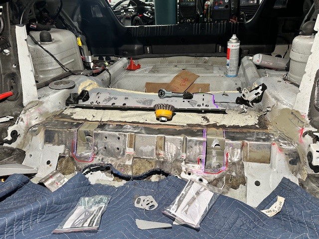

              I'm sorry some of these are sideways- they were taken for reference, not necessarily to post.
              Rear RACP Reinforcement:

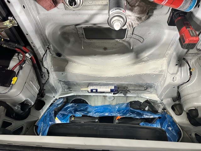

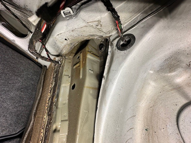

              Trimming trunk skin behind spare tire well.

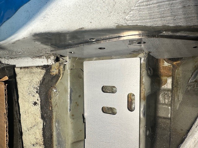

              Rear bar with frame rail attachments- the rail plates get welded on to the bar reinforcement.

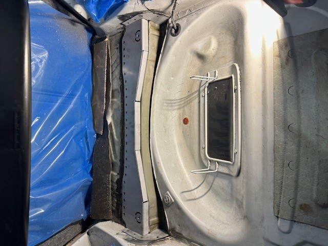

              Complete the structure with top bar. This then gets spot welded (all the holes are spot welds). When you're done spot welding, you'll stitch weld the perimeter.

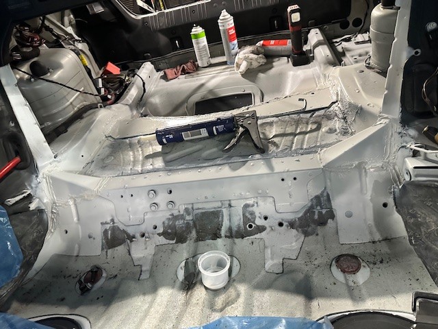

              Cover it back up with the panel you cut, stitch it back together, seam seal, and paint.

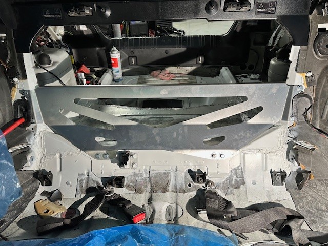

              Structure in place and welded, seam sealed, primed. It was later painted Alpine white.

              Bolt-in flush-mount roll bar is an option here. There's also K-braces for the trunk, etc.

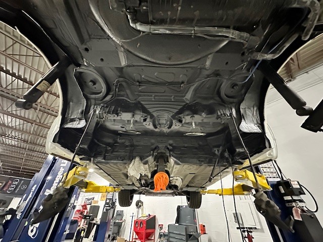

              The underside reinforcement is pretty self explanatory, but here is it finished. Happy to help if you order the kit and need any help.
