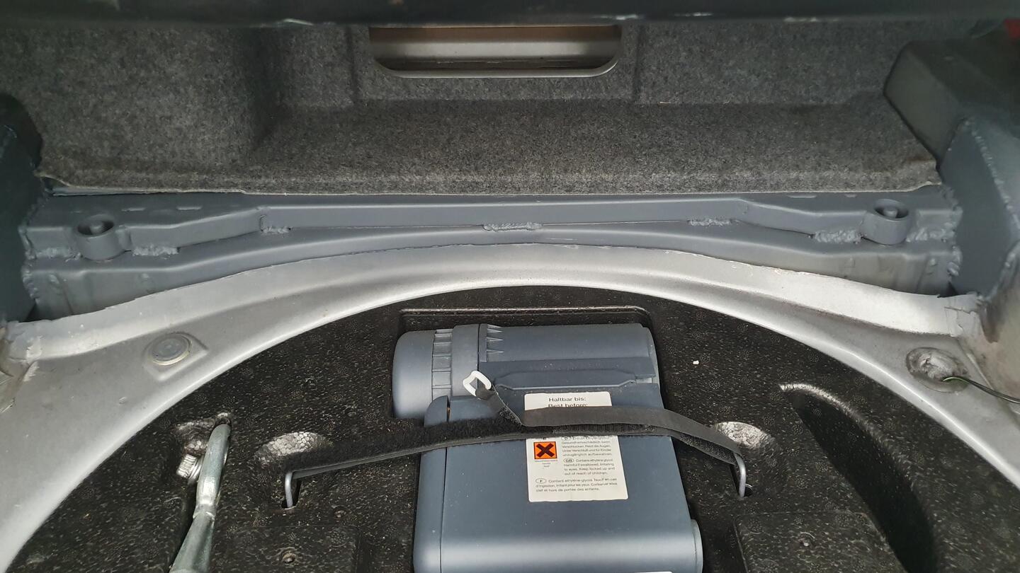

          I had to message vince directly on fb to get my kit. Here are some pics of my epoxy rivet kit during the install. Sorry but i never took photos of the bar and kit itself.
            Copied from my build thread:
            Then I drilled the pilot hole for the front mounts from the bottom, poking through the top-most layer of the floor. Then used a holesaw from the top-side to allow access to the internal MIG welds (which weren’t cracked) at the top of the threaded insert for the front subframe studs:
            Then started cutting the top-most layer of the rear section:
            Had to do a couple of minor trims, before a test-fit of the bar:
            All the grinding and cutting sure makes everything in the garage dirty:
            Started removing paint on the areas that will be epoxied, and applied POR15 Metal Prep to prevent rust:
            Then, epoxied and rivetted everything in place:
            It ain’t pretty, but I covered all the exposed seams and remaining exposed metal with POR15:
            Also got my new rear shocks, RSMs, and reinforcement plates in during reinstallation:
            Managed to button up the car the last night of the weekend, and decided to fabricate the cover and clean up the car the next weekend. Turned out that pre-cut steel plate that was sent with the kit was too small, since I guess I cut the rear top-layer too big:
            So I made a CAD template, bought some sheet stock, and re-made it:
            Then rivetted the whole lot together and seam-sealed the seams:
            Then POR15 all exposed metal and seam sealer. Again, it ain’t pretty, but it’s not something I look at every day:
            If I could go back and do it again, I’d take a lot more time protecting the interior. I had a few cheap towels laid out, but clearly they weren’t enough. It took me forever to clean the carpets, and I now have permanent craters in the headliner and pitting on the interior of my windshield from the sparks:
            Oh well, at least I shouldn’t have to worry about my RACP ever again.

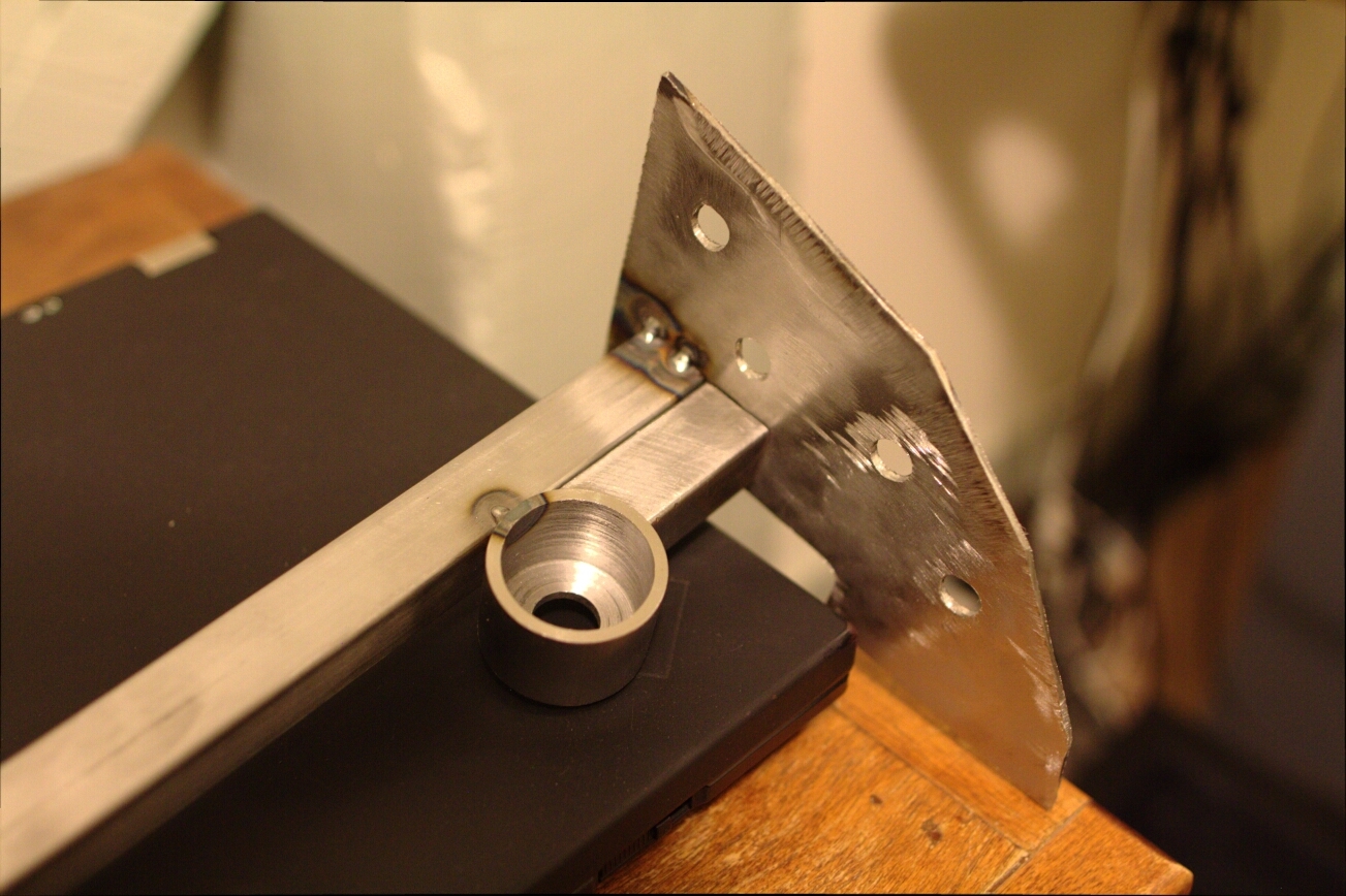

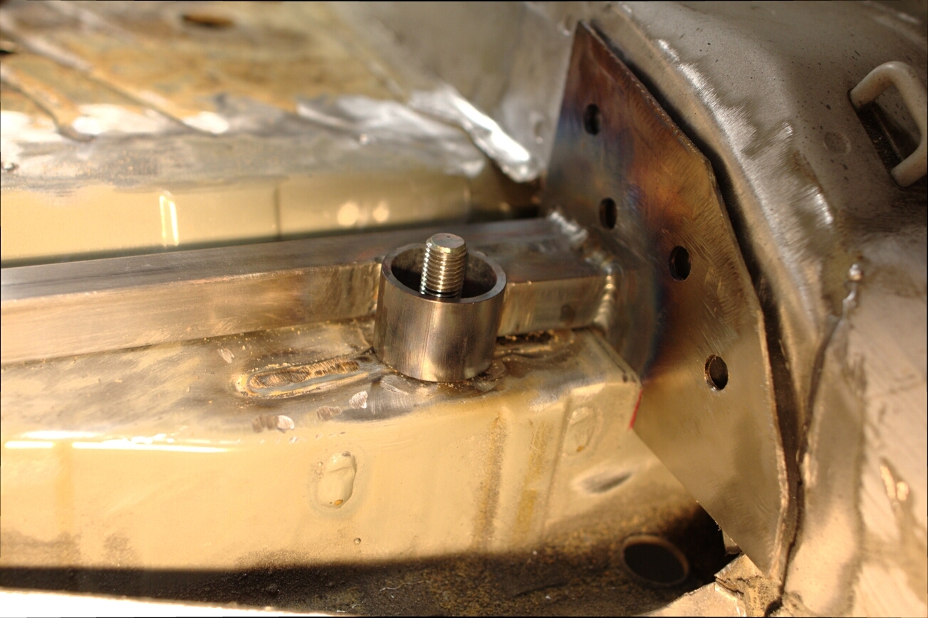

                    Reasonably straightforward to manufacture the bar (as I did):
