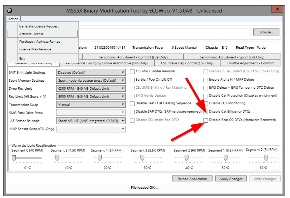

              You want to check both those boxes if the 02 sensors are physically removed, the upper box is if you don't have catalytic converters (or bad cats) and the lower box is if the 02 sensors are disconnected completely.
              You need the 02 sensors in the headers as they determine air fuel ratio, the 02 sensors in section 1 are for emissions only.
              That said you can either check both those boxes OR reroute your rear 02's/EGT to the euro section 1 and if the cats are still good you should be fine.
              Also, yes, make sure and backup your stock vehicle tube, I usually have it on at least 1 computer and a USB stick as well just in case.

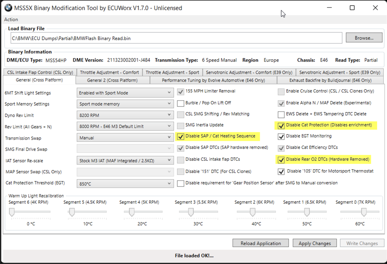

                      I just dumped my ECU and I was surprised as to what I found.
                      My concern and goal is add EURO Cat-less headers to my otherwise stock but ESS G540 Supercharged E46 M3. This sent me down the rabbit hole of contacting ESS asking for guidance and they kept stating they will not disable emissions equipment etc. not even for a track car.
                      That said, I loaded my partial ecu dump to MSS5X_Binary and all the CAT and O2 disablement flags we discussed are already checked off, also the region shows "Europe".
                      This leads me to believe that I should be able to install these headers, run completely cat-less and have zero issues or check engine lights, am I missing anything here ??
                      Thanks.

                        As long as you can make the necessary changes in the binary modification tool you should be fine. Usually if a tune is "locked" you cannot even read it, but if for some reason your tune is locked and you can't make those changes you will have a check engine light.
                        It sounds like ESS won't tune out the 02's for legal reasons, which is smart for them, there are other options if you need another supercharger tune and 02's off.
                        That said, hopefully you can just make the modifications to your current tune, much easier/cheaper.

                          I successfully dumped my ECU and opened in MSS5X Binary. According to the FAQ, all the current settings / values should load with their current values. To my surprise, the ECU dump I just took of my car already shows that the CAT and O2 checks are disabled. I just found this rather suspicious when ESS gave me the round around on this. Not sure what to make of this, seems as though I dont need to flash any changes.
                            Were you able to write the changes made with the program onto the DME?
                            Edit: Got it, sounds like you were good to go from the start.

                              I did not attempt to "Write" any changes yet. I'm holding off for a hot second because my gut says I have been good to go from the start, just like you said.
                              I was hoping someone with more experience than I could confirm.

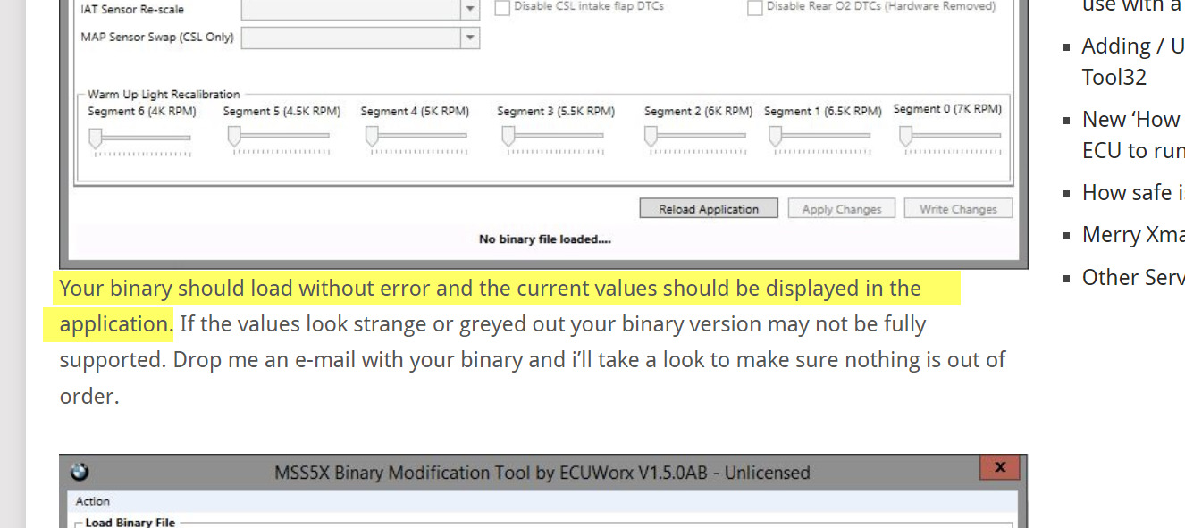

                              Sample from the FAQ: Unless I have a false positive here, I feel like I may be good to go ?
                              Click image for larger version  Name:	image.png Views:	0 Size:	239.8 KB ID:	322253​

                                Martyn from ECUWorx emailed me back. He confirmed what I thought. The tune I have is already configured to disable to the cats and rear 02 per my screenshot. I dont need any tweaking and should be good to go with my install. At least I learned something new this week. Thanks for all the help pointing me in the correct direction to figure all this out, this forum has been the most helpful of any I have joined, I will be hanging out here from now on.
