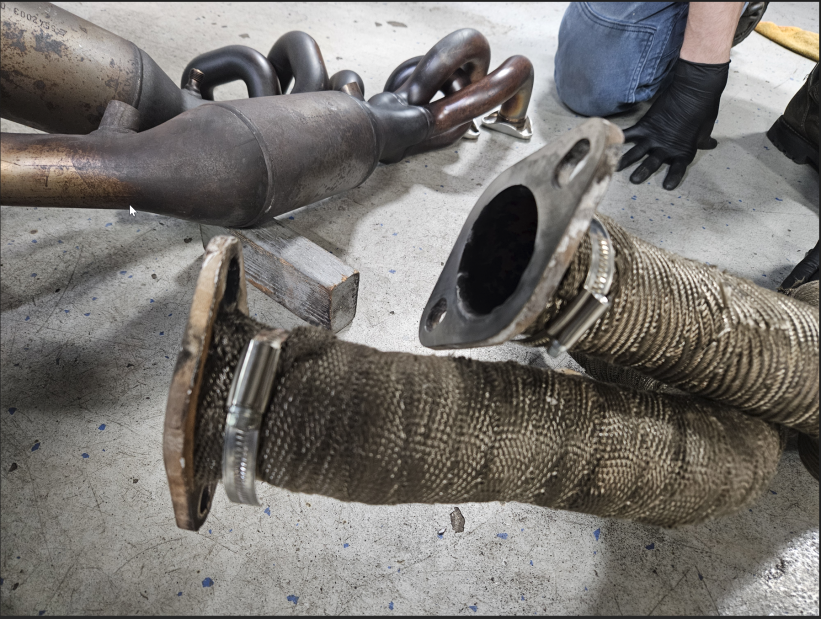

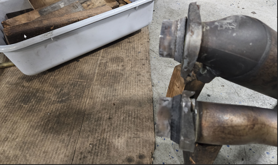

                  My Stock headers:

                  The "EURO" headers I got...

                    Ouch, that is modified and how.

                      Those are definitely not euro headers…
                        #41
                        Those are generic flanges. The flange section of RHD headers is exposed to UK weather and when moisture gathers under the flange and lower gasket, its rusts and can create cracks. Being the UK, some cheap repairs include cutting off the lower flange section and welding on something like that in the picture.
