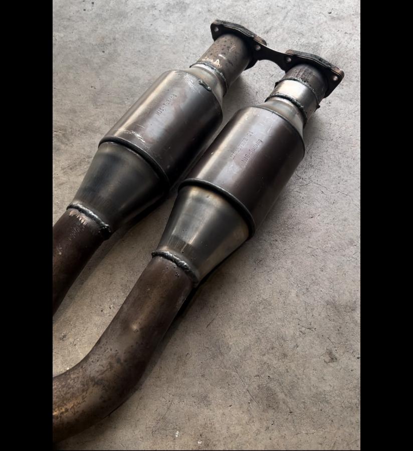

            Which model HJS cats? That sounds best - cut up my section 1 add in right cats and bungs and good to go?
              Yes, O2 bungs and might as well add the EGT bung in the same place as the Euro section 1
              9095 0092 HJS Hi-Flow Universal Catalyst​
                    Please share your reasoning for installing the O2 and EGT bungs in a custom section 1 with high flow cats. I’m curious about this, because I want to monitor AFR…but I don’t want to add any risk of damage to the cats that might result from the process of installing the bungs on the body of the cat.
                    Related to monitoring AFR (not emissions compliance) I haven’t asked my tuner yet if it’s his preference to monitor AFR pre cat or post cat. If he wants pre-cat I would just see if o2 sensors fit in the space available using the Megan headers.
                      It is mainly to mimic the Euro section 1 and SS HJS section 1. If the sensitivity of the rear O2s are turned down slightly in the tune, it will operate like a factory setup. EGT is mainly there for cat protection and there might be one fuel map where it is a small factor (probably for that cat protection/enrichment). Based on others who are running a catted SSV1 setup, the rear O2s and EGT bungs are not necessary, and the monitors can be set to ready and the errors turned off.
                      As for AFR tuning, either pre or post should work just fine, but I imagine the pre-cat location is best. Dyno operators typically place it on one of the four exhaust tips, so less of an ideal spot and they are still able to roughly check AFRs. On the Megan and SS headers, it is a nice that those extra ports are already there.
