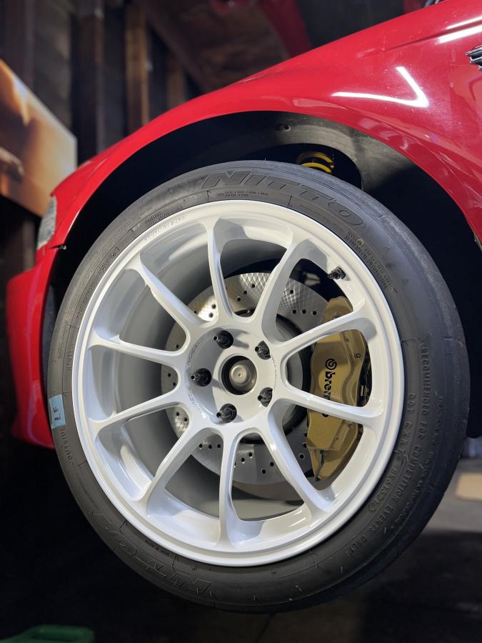

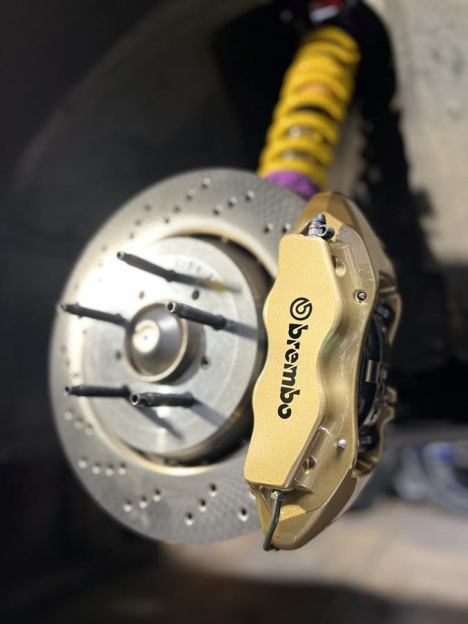

                      My setup

                            Here is a picture of the Brembo GT caliper from my old car.
                              The 44/40 pistons should also help to avoid the tapered pad wear from the 40/40 pistons that people have reported.
