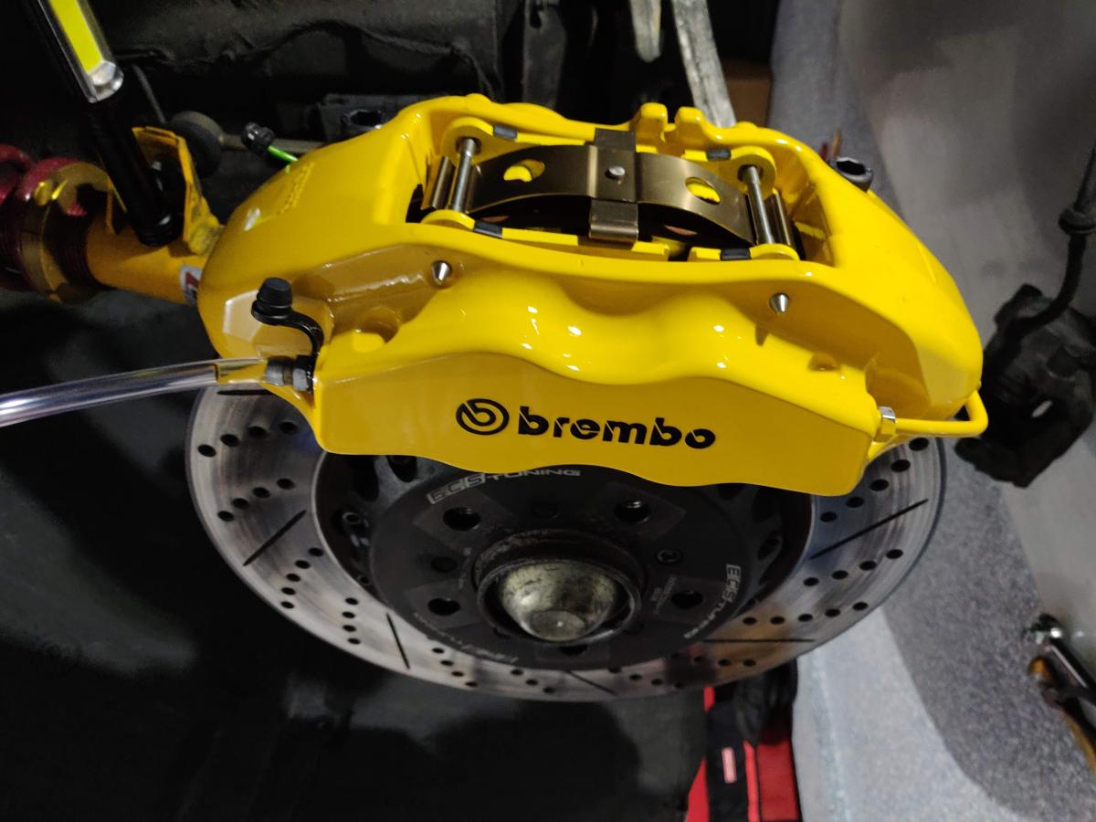

            Originally posted by newton22 View Post
            I run DB9s. I ordered from VBT in 2018.
            Edit: Not sure why it rotated the image for me
            Click image for larger versionName:	IMG_20210308_200221.jpgViews:	0Size:	97.9 KBID:	253708
