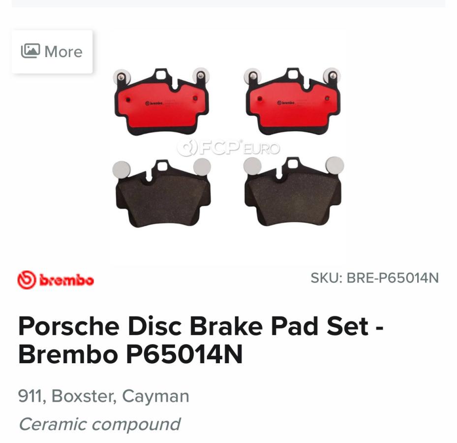

                    What was the part number of the Brembo ceramic pads?

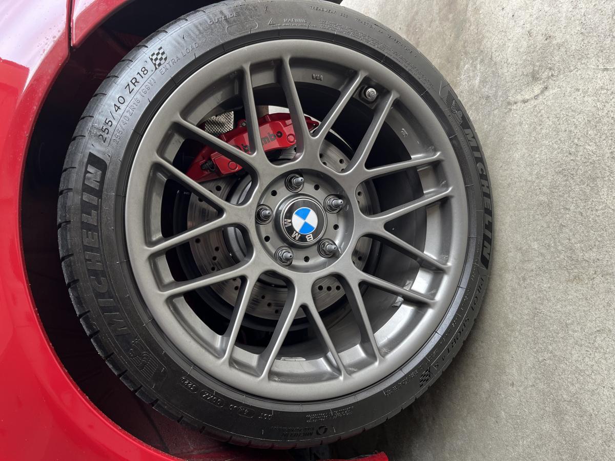

                      Bumping this as after Bry5on thread I jynxed myself and now have noise from hell with my new Megane front 996 rear setup. I only have a few rides on the setup, and they were quiet at first during and after bedding. I see folks have issues with slow speeds coming to a stop, mine are actually crazy loud on harder braking too. Sometimes, I assume when cooled off, they actually go silent again.
                      Setup includes Zimmerman cross drilled rotors, Powerstop z23/z26 pads, new dampers shims on the rear, plenty of copper grease on all metal to metal contact points.
                      Do I just need to try a different pad ? Wondering what folks think.
                      I had some squealing issues initially, and all I had to do to fix it was to use tue red shim from the Brembo ceramic pads, I scrap the pads and kept the anti noise shim.
                      What brembo pad are these shims from?

                        This is just an example, not the actual pad, but it is the red shim that seems to come only on the ceramic compound versions, I did not like the bite of the ceramics and went to OE Textar, I started to have screech noise when coming to a stop whenever the brakes warmed up and then read about pad shims for noise and I had the idea to test and transferred those red shim to the Textars pads. I don't understand how does shims work fully, but they made the noise go away.
                          When you ran these brembo ceramic pads, did you run them in the rear without the piston shims? and did you have any squeal? what type of grease are you using.

                            No piston shims. With the ceramics I had no squeal.
                              Obviously I have this brake set up, and came up with this solution. I now run textar pads with shims, no noise. The key I believe is making sure you have good contact/seal between the shims and the pad. I respray mine with 3M super 77 adhesive and make sure the shims and pads are completely clean (acetone).
