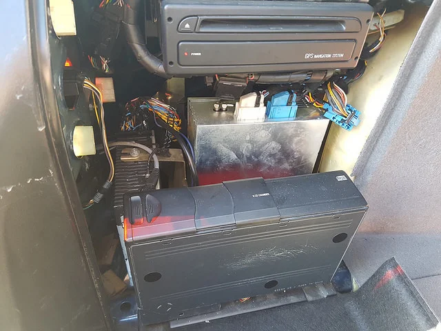

      The installation is very easy. The CarPlay comes pre installed in the OEM tv /video module, which already has a bracket for it in the trunk. See photo attached.
      You can either disconnect the blue connector on the nav and connect to the tv tuner or I can supply a retrofit cable, which piggy backs off the nav unit, and you can keep the nav and the oem nav interface.
      For the touchscreen, you have to feed a wire from the tv module to the monitor.

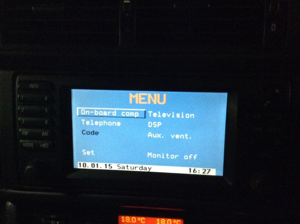

              I’ve attached the photo tv modules oem interface. It has 2 shades of blue and 2 shades of brown, and also day/night setting.
              Makes no difference for oem controls or touchscreen. I run my M3 with just the tv module and CarPlay. Lightweight race car
