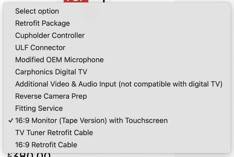

                        The main CarPlay option is all you need, but there are some other options, depending on your personal needs.
                        You have a 2002 car? Which means you have an older bm53 radio module, so won’t have an aux input. The firmware can be upgraded, if you want to send it over to me. Can also get the stage 2 amp upgrade to improve the sound on the bm53. This boosts the stock amps from 20/25 watts per channel to 50rms watts per channel, using pioneer mosfet amplifier ICs.
                        If not, then the audio will go through the cd changer input.
                        If the cd changer works, I can send the cable for it, if not, I will send something to replace the cd changer.
                        For hands free, most US cars came with telephone prep. So you just need to check which connection you have in the trunk and I can send you the correct connector and microphone.
                        The CarPlay is installed into the OEM tv / video modules. So you can either disconnect your nav unit and connect the CarPlay or I make retrofit cables.
                        If you have a coupe, it’s easy fitment, as your bracket is designed for it.
                        Here is a guide for fitment. Most of the beginning is for older cars like e38/e39.
                        Feel free to email me or WhatsApp me.

                            This would be for my 03 M5. These are the only options I see on the e39 page. The X5 page, however, seems to have the option you mention (top one), is that it? What does the installation process look like for the touch screen? And last question, what is the purpose of the modified mic?
                            If i like it on the M5, I'll definitely get it for the M3 as well- which I think might need the whole retrofit package since mine didn't come with the Nav
