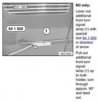

    Has anyone used an LED in the side marker/indicator, like so:

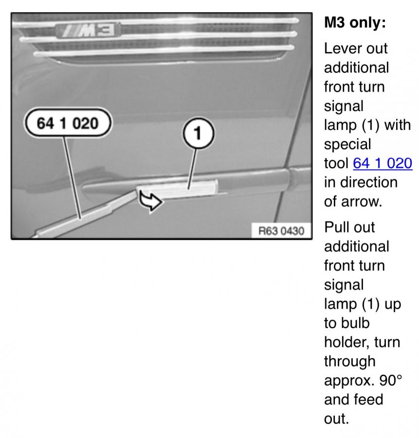

    Also, what is the best way to remove the side marker - push towards the front of rear?
    Here you go

      No one ever used an LED in the side marker?
