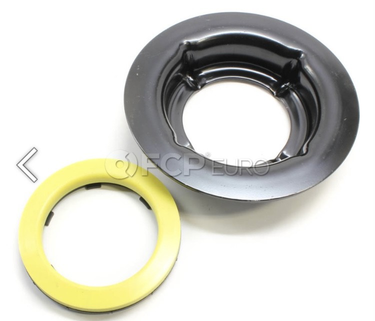

                      Based on the little triangular logo on the rubber portion, it looks to be made my Lemforder. The black and yellow radial bearing is made by INA.
                        https://www.fcpeuro.com/products/bmw...yABEgJnBfD_BwE
                        Yes I posted I thought it appeared to have the triangular Lemforder logo on the rubber for current stock in photos. Corteco having made it and now stopping has hurt the aftermarket on an solid OEM replacement.

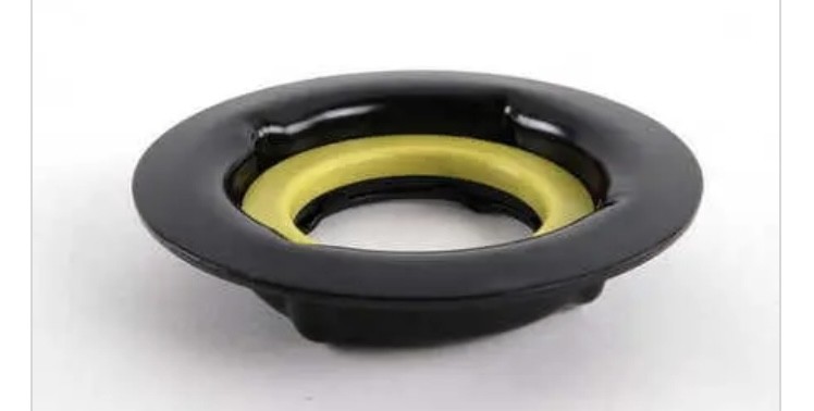

                          Another question for the forum. Are many of you just replacing the bearing unit and keeping stock top with good results? The factory bonded rubber to strut mount is a good isolator. As we know sloppy rubber means suspension moves and doesn’t allow suspension to work or respond quickly. The rubber in mine isn’t cracked, are people just replacing the “bearing” and happy? For those who aren’t familiar here is the bearing of the strut mount referred to.
