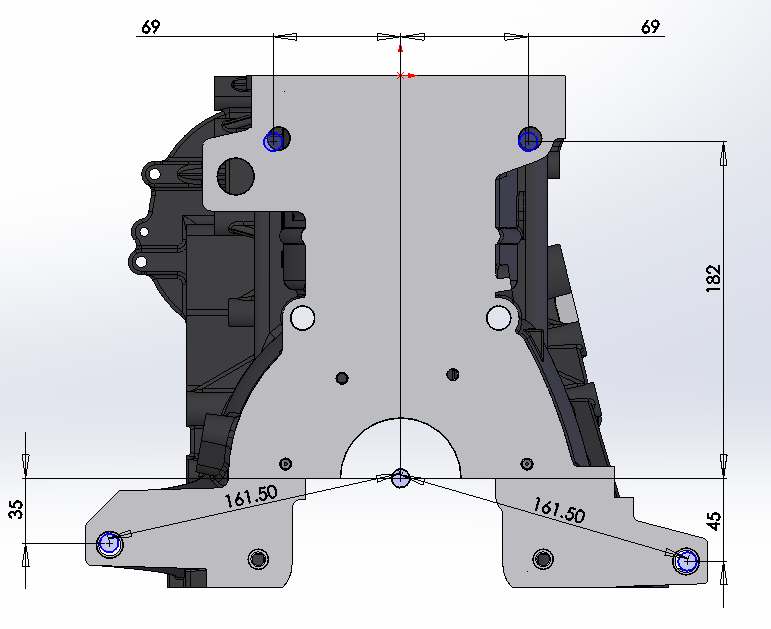

      You should do some confirmation of measurements on that cad file. If it's the same one I have, the dimensions are incorrect in a few places on the block.
      Edit: see images of the model vs the actual bell housing bolt pattern.
      Click image for larger version  Name:	image.png Views:	0 Size:	50.3 KB ID:	256477​

        You should do some confirmation of measurements on that cad file. If it's the same one I have, the dimensions are incorrect in a few let places on the block.
        Is it in Italian ?
          Yes. It looks like someone's senior design project or something. Definitely not an OEM model.
          Edit: it's better than nothing but I'd verify measurements before quoting parts or something.

            Yeah, If I were to go down the path I'd probably 3d print one, on a Bamboo 3d printer, and then compare measurements to an oem one.

                I have CAD files for the rocker arms … and the entire S54. At this point (wait time wise), it might be worth it to CNC some and then get them sent off to get DLC coated.
                BUT, I'm not sure how accurate the CAD file is. If I weren't so lazy I'd 3d print some and then pull a rocker arm off my car and take measurements to compare.

                              I have to ask. Have you even seen the model that were talking about? It's very good but some dimensions on the block and crank are incorrect which makes me suspicious.
                              This is not a complicated part to recreate CAD for by measuring an OE part. 3D printing is a good tool that can be used to validate everything as well.
                              Getting the correct finish and hardness on critical surfaces will be the more difficult task.
                                Yep, have had several people reach out for the file who had the same approach as me, to 3d print one of each rocket and to compare the measurements to an oem one. I also had another person reach out from Germany who already has a source for the DLC coating.
