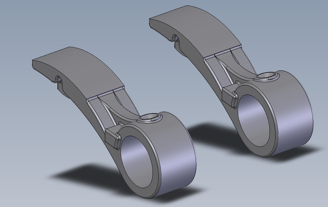

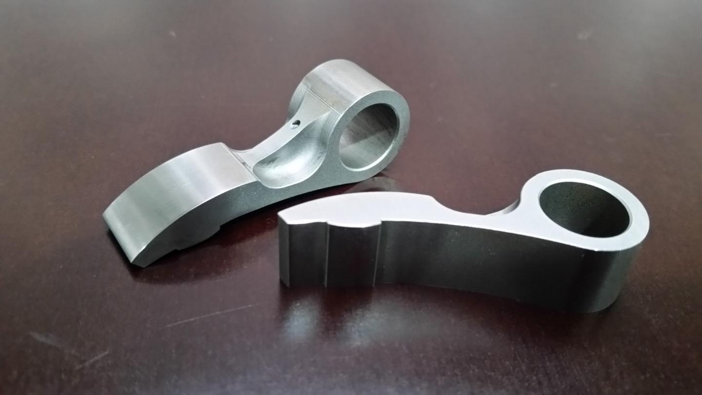

    People are dreaming / wishful thinking and I don’t actually think being serious. There is no way the geometry is accurate and it’s not even suitable for CNC. The rockers from schrick and catcams are expensive for a reason and it’s not because they are trying to rip you off. you just aren't going to make significantly cheaper ones that are actually any good. I have seen at least half a dozen different aftermarket rocker designs for various bmw engines they end up being expensive if they work longer kms and all have some kind issue/flaw
    The Schrick units appear to be similar to OE in that they appear to be cast followed by machining and some coating or hardening process. No two ways about it, it's an expensive endeavor from design to metallurgy, foundry QC, machine shop QC, there is a lot to it.
    '07 M Coupe - RAC RG63 - AutoSolutions - Bilstein PSS10/B16 - Arqray
      #32
      I have to ask. Have you even seen the model that were talking about? It's very good but some dimensions on the block and crank are incorrect which makes me suspicious.
      This is not a complicated part to recreate CAD for by measuring an OE part. 3D printing is a good tool that can be used to validate everything as well.
      Getting the correct finish and hardness on critical surfaces will be the more difficult task.
      If I remember right that model was part of some Italian engineering student’s thesis project. It’s overall impressive, but should not be considered equivalent to BMW’s original cad files
          The model appears to be for the OE which is cast or forged not billet so the geometry is not made suitable for CNC billet. The catcams rockers are how you would do billet.
          http://www.catcams.com/tabid/432/def...?tabfile_ID=61
          compared to the attached​
          You need to get a new oe one and get it cmm if you are serious about billet CNC not use random cad files. 3d printing is not accurate enough to validate the radii and centrelines thereof for the foot etc in other words the cad file is pretty much useless
            #35
            I think we've covered (ad nauseum) that OEM parts should be measured.
