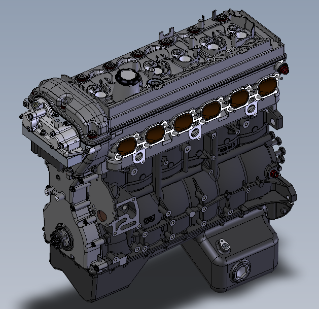

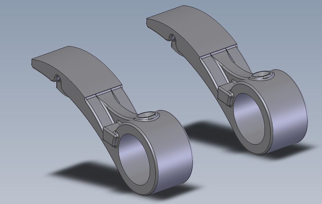

                          I have CAD files for the rocker arms … and the entire S54. At this point (wait time wise), it might be worth it to CNC some and then get them sent off to get DLC coated.
                          BUT, I'm not sure how accurate the CAD file is. If I weren't so lazy I'd 3d print some and then pull a rocker arm off my car and take measurements to compare.

                              I can share the files if anyone wants.
                              That would be cool!!
