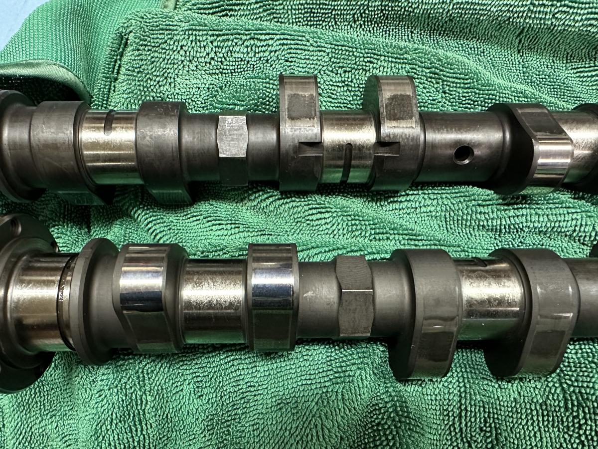

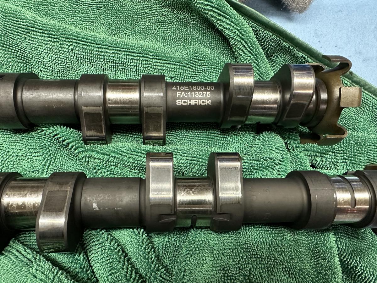

                  I'm aware of 4 variants.
                  Original - See the picture from Obioban's thread below. Cam looks near identical to BMWs, appears to have been ground from the same blanks. Standout features compared to newer Schricks - hex area to turn the cam is smaller diameter than the shaft, and the flat surfaces of the lobes have a textured finish to them
                  The rest seem to be variants of what turner calls the new "cast" cams. There seem to have been two variants of the coating, a black one and a light gray one. And now an uncoated variant. All pictured below. Unclear if metallurgy changed during those transitions, nor do I know what the coating is actually made of. Visually asides for the coatings or lack thereof, you can see the hex area is larger diameter compared to the shaft, and the lobes have a smooth finish on the flat surfaces where BMW's and the "OG" have a textured finish. Looking it up, I think the 'coating' is a result of nitriding the cams, still not sure what the significant of black vs grey would be, but that could explain why the 'uncoated' ones seem to be failing - they don't have the surface hardening that is expected.

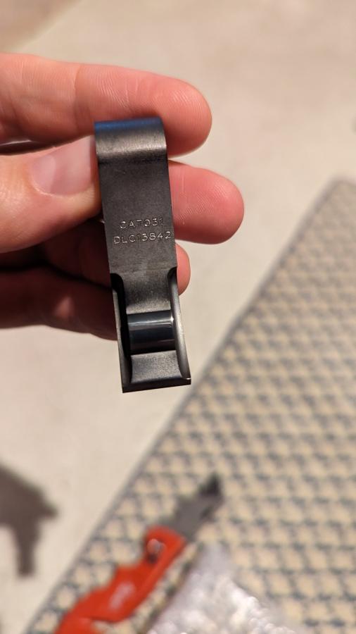

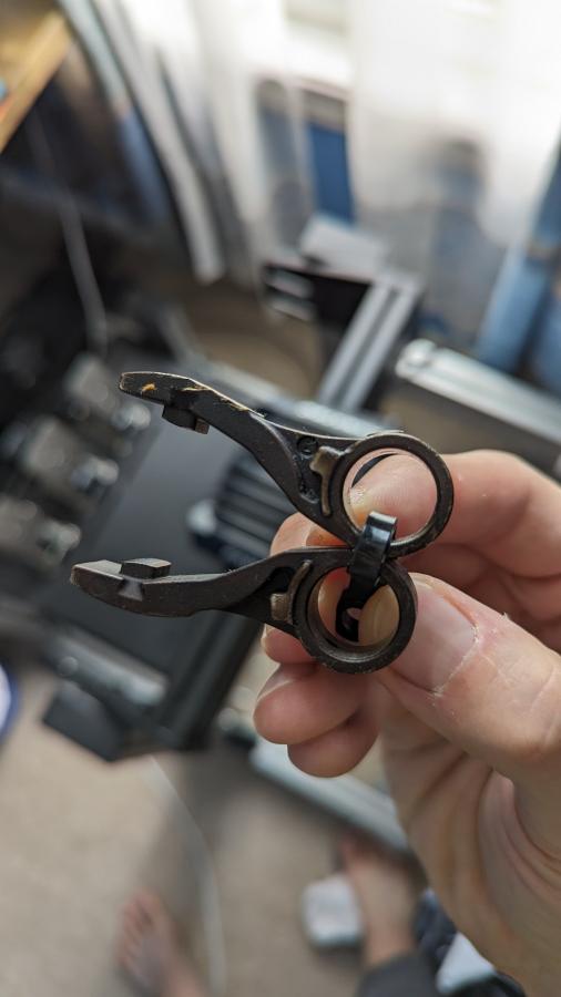

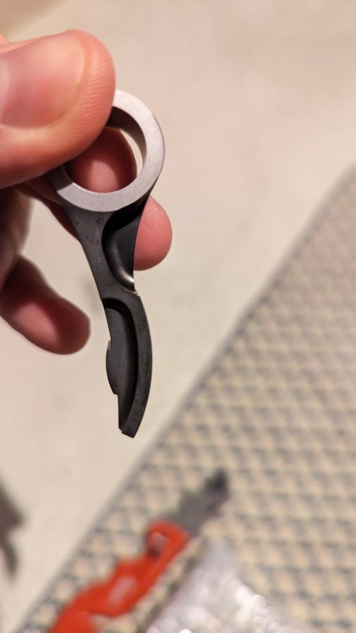

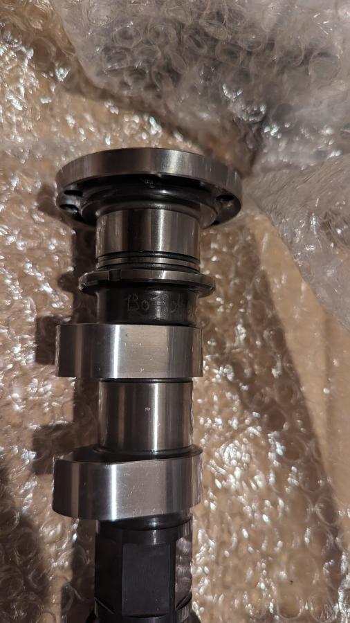

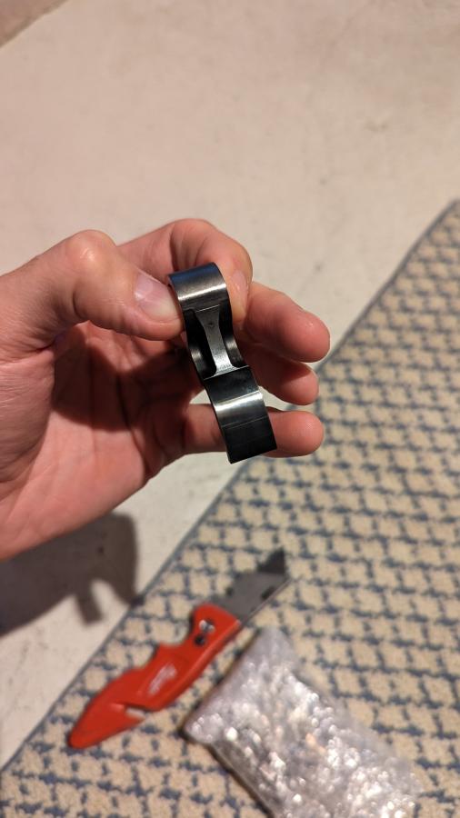

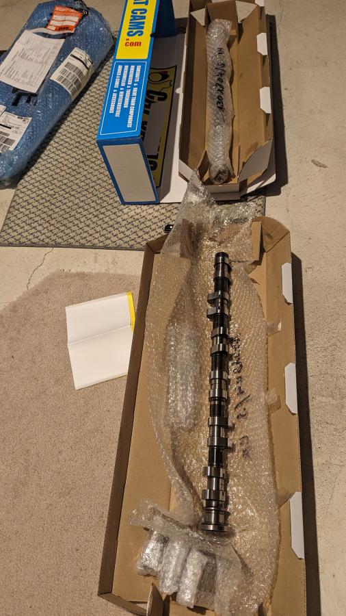

                              Noting the above, I really think getting cams now without the supporting DLC followers is literally lighting money on fire. I know lots of owners here have done even 288s on OEM set of followers but i strongly believe that's no longer possible.

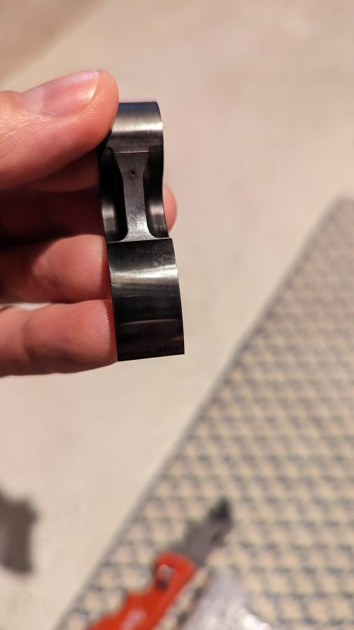

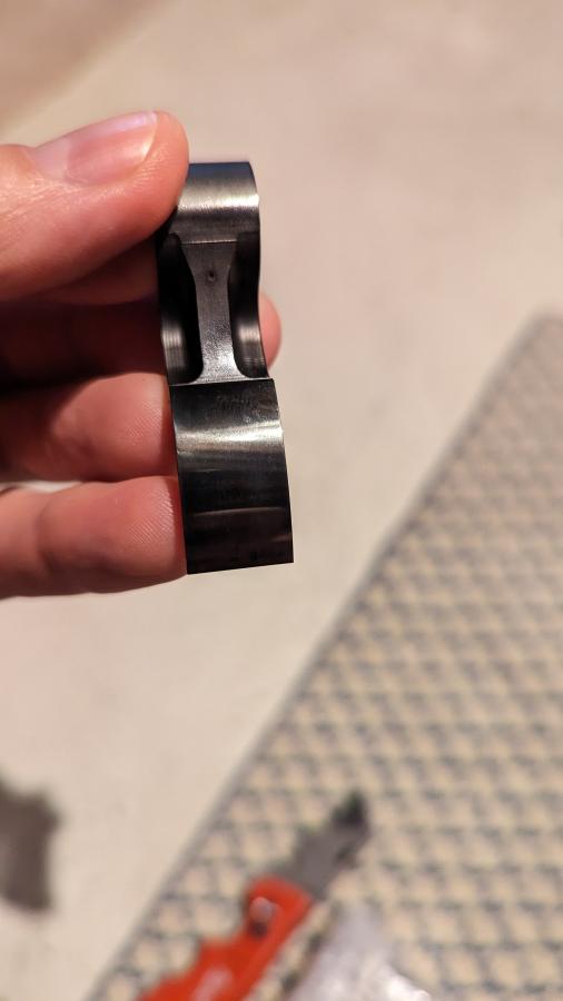

                              Also I've gotten a new set of CatCams with supporting followers and oil bridge, thanks to Syfon for the very smooth and accommodating transaction. Much like the Schricks, these are also polished. If anything from what I remember when the Schricks were new the surface of the lobes seems to have smoother qualities or look, but that may be just placebo. The followers by comparison seem a lot better even if new vs used. DLC application seems to be on the tongue and the bottom piece that touches the valve assembly.Pics for reference.
                              Speaking of coating, is it worth it to get the cam lobes done in WPC at this point?

                              This is Cyl6 last damaged follower.
                              Click image for larger version  Name:	PXL_20230708_151124160.jpg Views:	0 Size:	38.4 KB ID:	224725
                              Click image for larger version  Name:	PXL_20230708_151133702.jpg Views:	0 Size:	38.1 KB ID:	224726
                              Penultimate Cyl6 Follower, both changed for new OEM.
                              Click image for larger version  Name:	PXL_20230708_151203155.jpg Views:	0 Size:	32.9 KB ID:	224727

                                Things probably have changed since our cars pile up mileage and age. Did the flat spotted follower damage the cam?
                                I think WPC or REM polishing would add some benefit of better oil film retention and thus less wear and heat. Not sure much of a difference it makes. I have REM polished the shafts that the follower sit on just to try some day. I think Partee Racing bought them...he hasn't asked for more so I don't think its a huge deal.
                                The problem is, at least with REM polishing, is the proportions of long shafts increases the cost significantly. I can get a ring and pinion gear set polished for half the price of a single cam.
