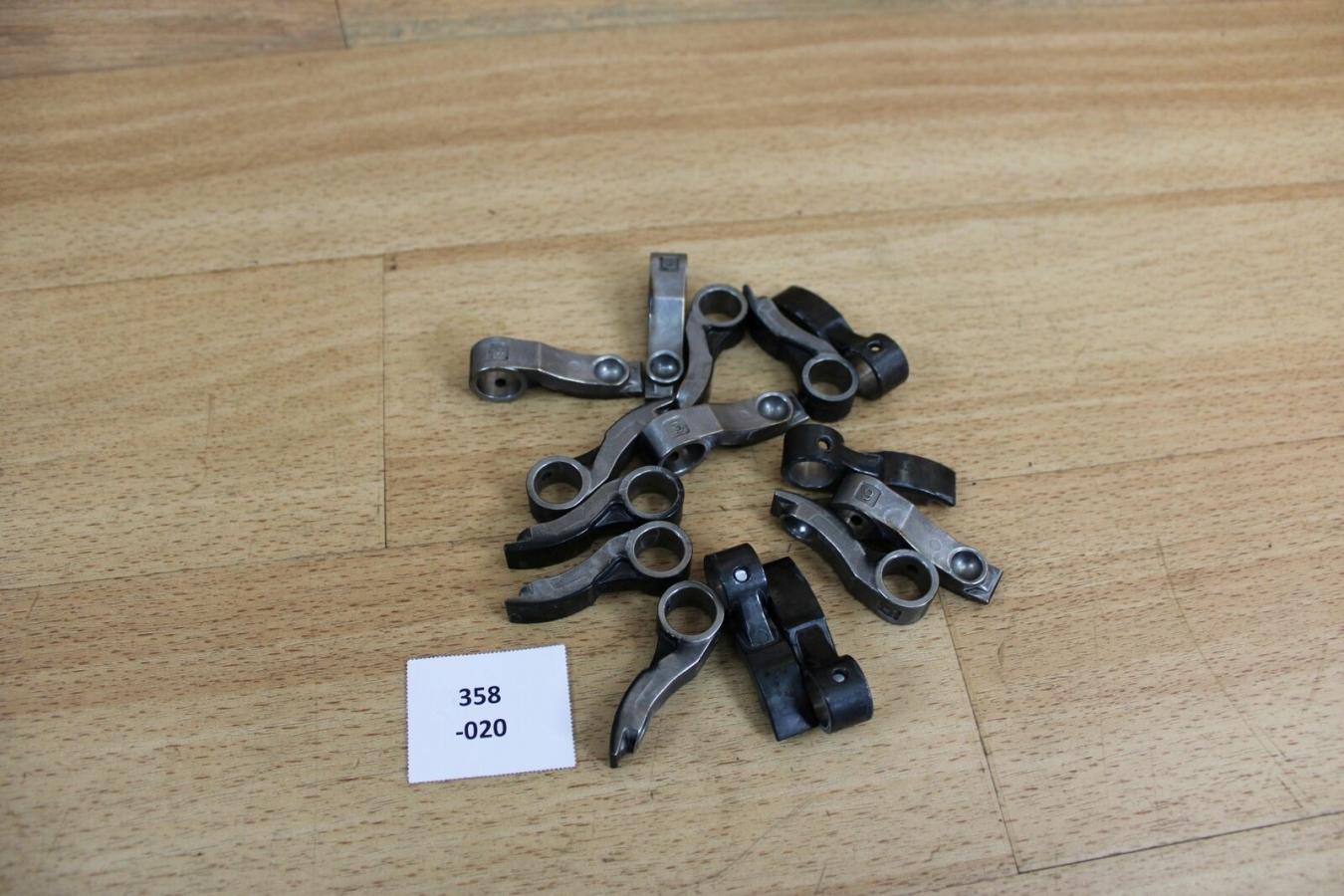

ID:	220947​I wonder if any of the motorbike followers can be made to work. 11337724819 looks very similar to the e46 part, but seems to be designed to accept a dome shaped shim.

                  good idea. I’m not a metallurgist, but I don’t see the expense in these followers. Besides margin, why on earth are they so expensive?

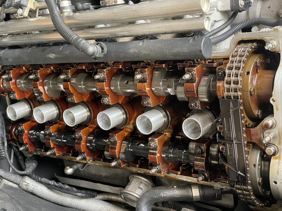

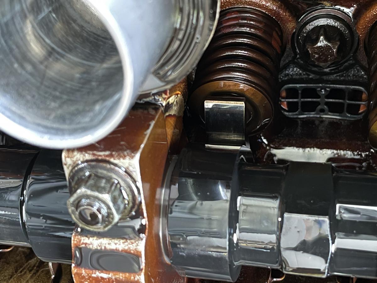

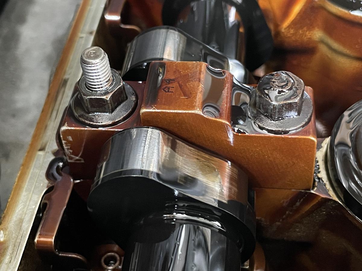

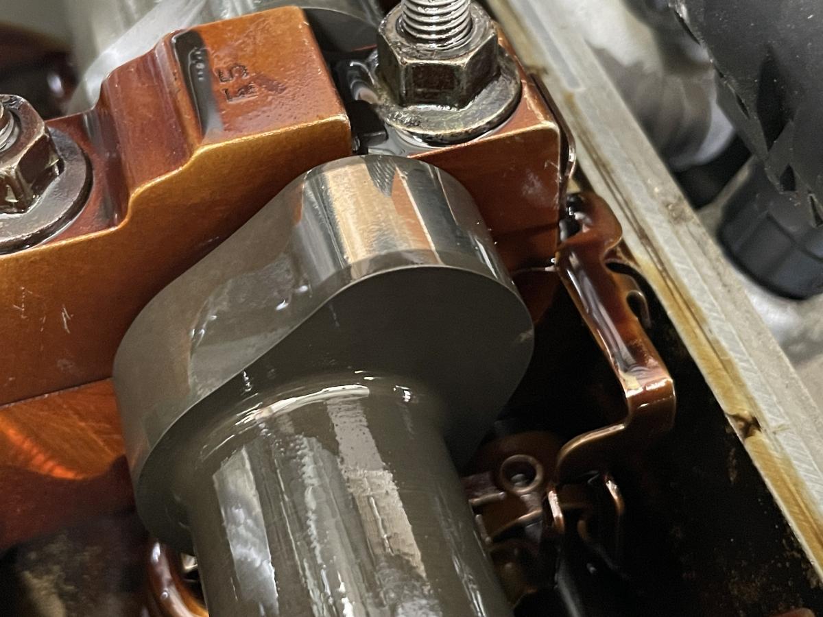

                          So for what it’s worth,
                          In process of valve adjustment on my car. Schrick 288/280s, circa 2019, installed with stock OE followed on a ~185k mile engine. Currently just over 200k now. Seems like they’re wearing okay. No flat followers or obvious flat spots on the cam lobes. Some representative shots :
ID:	222275 Click image for larger version
ID:	222274 Click image for larger version
ID:	222273 Click image for larger version
                              In process of valve adjustment on my car. Schrick 288/280s, circa 2019, installed with stock OE followed on a ~185k mile engine. Currently just over 200k now. Seems like they’re wearing okay. No flat followers or obvious flat spots on the cam lobes. Some representative shots ]
                              to be clear, you used the stock 185k mile followers with new schrick 288/280 cams?
                              good to know the use cases. Thanks for posting.
                                #60
                                Yep
