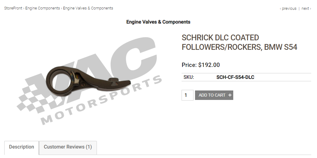

                    To follow up, the coatings will "work" with one another. In this case it will be DLC followers and WPC treated cam lobes. Talking with the WPC treatment place, they mentioned that doing a treatment on a DLC coated surface may or may not take that coating off they would only know after their treatment process has finished.
                    I can't go back to stock cams after feeling what it was like. So I've gone ahead and purchased the CatCams set off the forum here with the DLC followers and the bridge. There's no stock of followers on the net, and I guess VAC in their wisdom seeing as there is a shortage decided to up their price. I guess I can ask wpctreament.com if they have experience with the two coatings interacting and report back what they say.
                    Good guys VAC below. Bless them.

                      #40
                      i wouldn't WPC the DLC if thats what was discussed.
                      if using the catcams cams ,dont you need to use the catcams rockers for the "warranty" ? also WPC may void warranty claims?
                      $4,600 for DLC rockers VAC to the rescue
                        #41
                        If I had more than one set of dlc rockers I'd sell you some but it's a pretty shitty situation for these fools to be charging just south of two bills a piece.
                        I hope you get this sorted soon bro.
                          #42
                          I havent thought of that, voiding the warranty of the camshafts if they're WPCed. I would not wpc the followers dont think that would make sense.

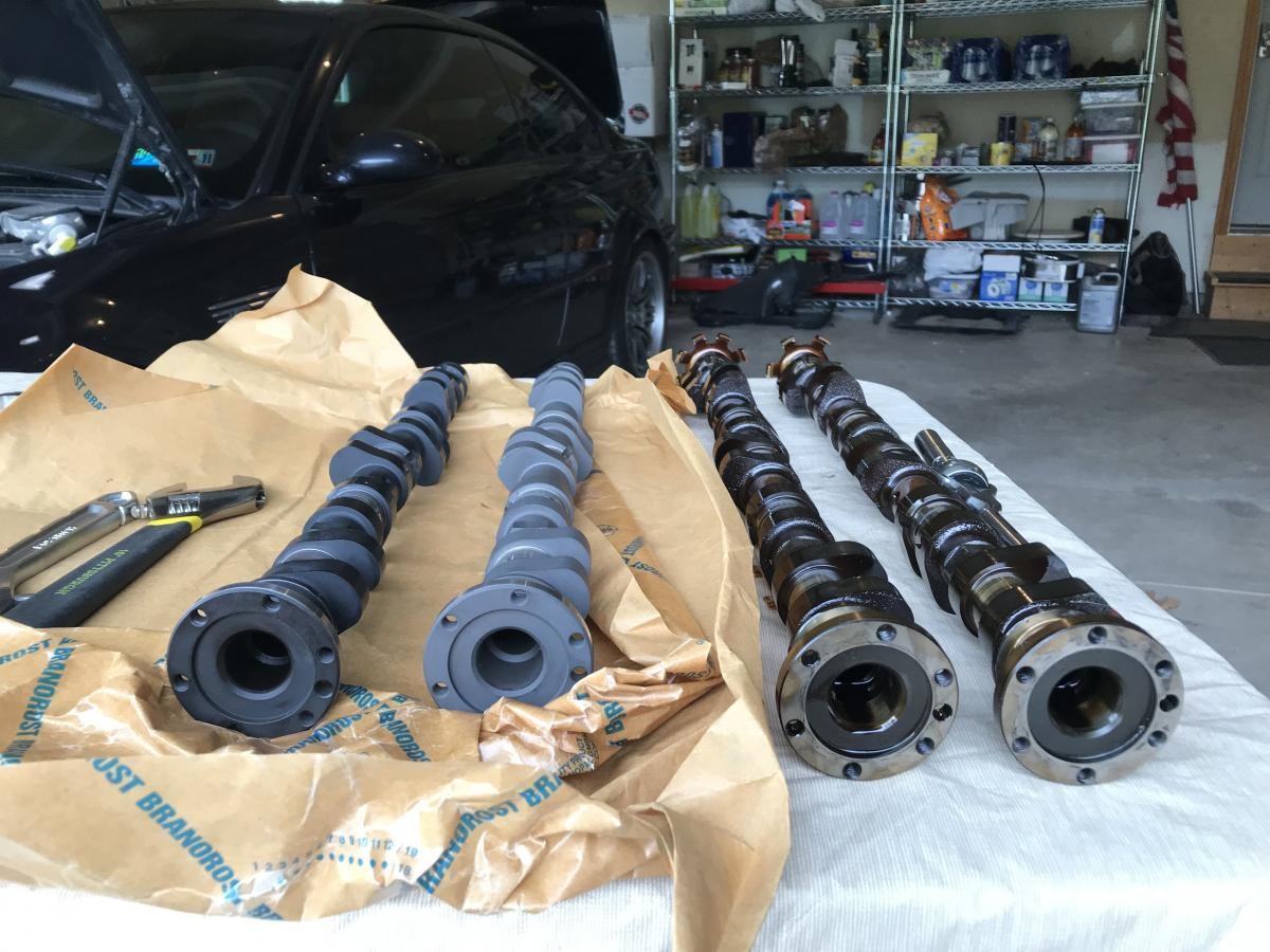

                              I haven't, might be worth it. Not sure they will answer. Cams just dont look like this anymore:
                              Click image for larger version  Name:	image.png Views:	98 Size:	153.3 KB ID:	220096​
                              Hmm interesting. Was there anything special about the coating? The actual cast otherwise looks the same.
                              For what it’s worth, the below are the 288/280s I purchased in 2019. I noticed the 288 had a Grey instead of black coating. Seems to be wearing okay so far.

                                #45
                                Click image for larger version  Name:	image.jpg Views:	0 Size:	208.0 KB ID:	220936
                                Are those the stock cams on the right side? For some reason, I thought you had 280/272s.
