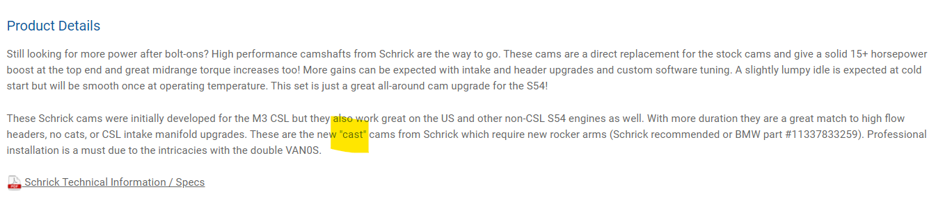

      Updated information is that no matter what cams you get, doesn’t matter the profile, new followers are required. I bought new schrick cams (280/72) this past year in November installed this spring on my car, even replaced two exhaust followers on cylinder 6. I got stepped cams now.
      Schrick cams are now “cast” per new products description. I’m confident this was a new development in the c19 era. Even vac didn’t have the required anecdote for this profile cams. They also come polished, cam lobes are no longer coated black. Unfortunately I’m out a lot of money cause warranties are not honoured unless you get their proprietary followers.

              I'm honestly not sure that when i bought the cams back in November 2022, that bimmerworld had their website updated with the new verbiage. But it's there now.

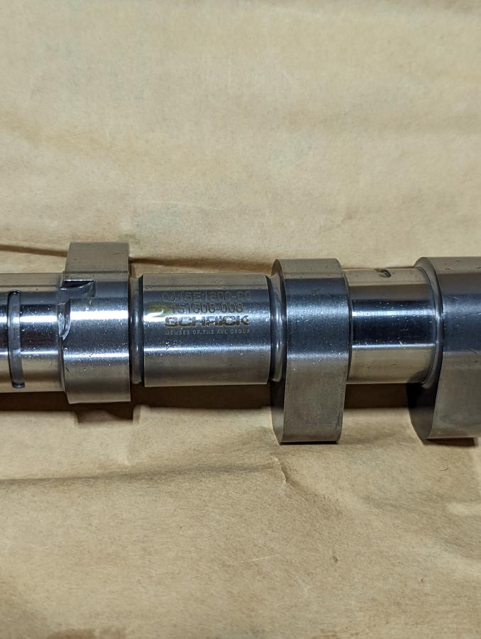

              This is how they look brand new. No longer coated black.

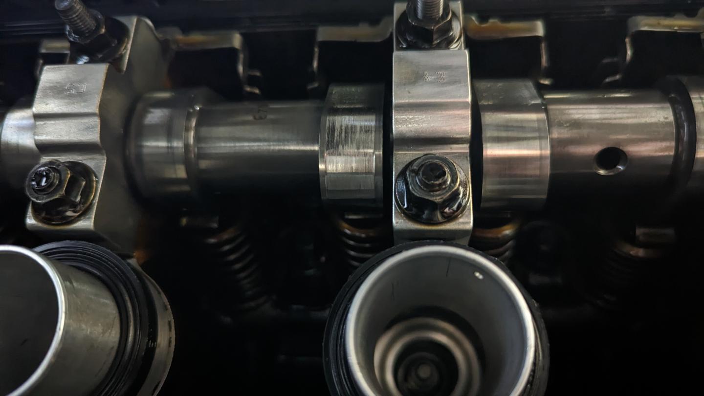

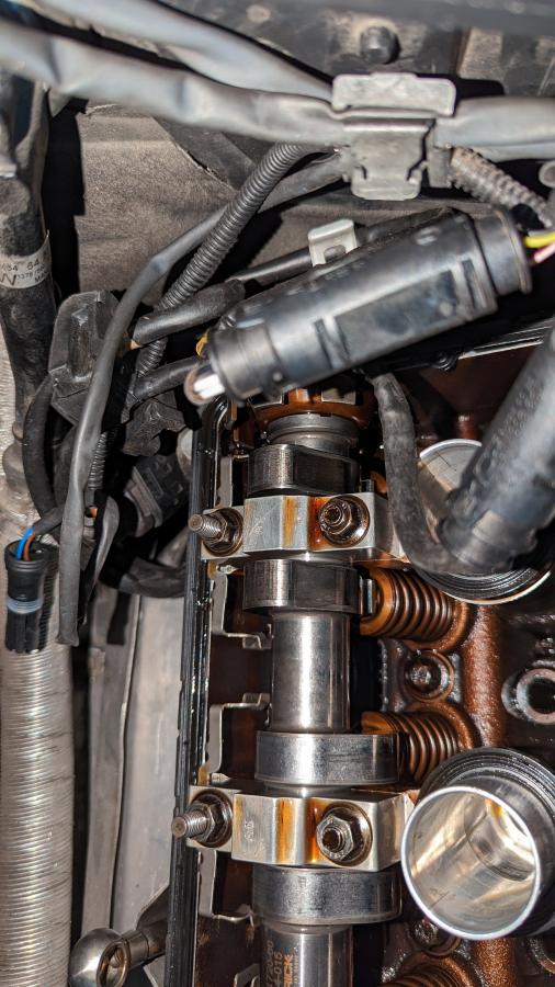

              And ofcourse they were installed by an experienced mechanic to Schrick bulletin spec, he's done this almost a hundred times. And he's never seen Schrick fail like this, but he's also never seen new ones either. Other than mine and another M Z4 where cat cams failed gloriously because they also are now "cast" and require this dlc followers. That case was way worse with around 3mm being shaved off the cam lobes and not just two cylinders like mine but all of them.
              Break in also done at initial start up, 3k rpm for a set time. All on new oil. Etc etc. 1000km part throttle under 4k for 500km and another 500km rarely up to 6k. Varrying rpm ranges not hwy driving.
              Dynoed, Hassan did great car did great. Had pretty good compression numbers with stock cams, but the top side was too noisy and i needed to see everything so that when this was uncovered.

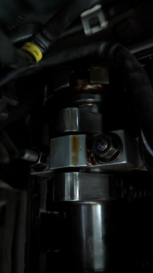

              Cylinder 6 was an issue beforehand when the stock cams were off, didn't like the followers how they looked. Replaced with two new OEM that the mechanic had in stock. Before the Dyno we checked valves lash and adjusted. Everything looked fine. After Dyno the noise i complained about in the Dyno thread got more pronounced (which is not the cause of this, it's still Vanos related) but it led to finding this out.
              Feels shit cause shit ain't cheap in CAD, and also after experiencing cams i can't really go back to stock. So yah, i can't in good conscience recommend anyone get cams without followers. What could have been a 3-4k job with 280/72s is gone now. I chose that profile of cam, and make ofcourse, on the basis of the OGs here who've done it before. A main component was the lack of followers needed. Compound that with the fact that schmiedmann doesn't have P45/P54 followers. There's only 17 in all of North America apparently. And shcrick is $88 a peice times 24, plus conversion duties and shipping, fml.

                        digger Ok got it now, so cylinder 6 is still the worst even after new followers were put in, although OEM not D(iamonddick)LC. The worst lobe is the last one, it has a distinct flat spot rather then the stepped look on the other cyl 6 lobe (the penultimate one).
                        Important to note there is no other damage on the cams other than the exhaust of cyl6 and cyl3 intake just one lobe.
                        jet_dogg The reason I think they are all the same, the MZ4 owner got new Schrick 288s and DLCs after the catcams issue, and the cams looked similar to mine ie. polished look not the old school coated (black) look.

                            I haven't, might be worth it. Not sure they will answer. Cams just dont look like this anymore:
