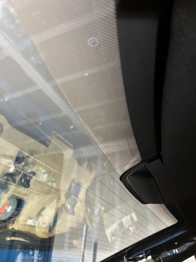

            would like to see some pics if any of you have.
            here's what my installer did. quite noticeable from the inside, not so much from the outside but still...plan on taking it back and discussing options.

              I would have them re-do it covering the matrix. You'll see those matrix with or without the tint...so I would rather see the even tint across the window with those matrix covered by the tint.
