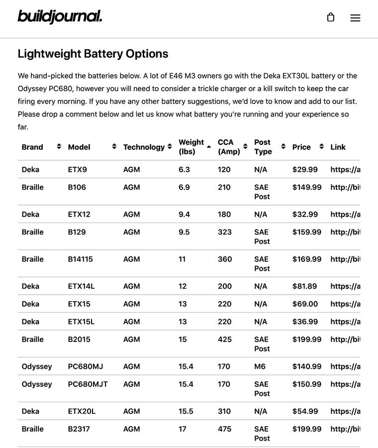

        The enthusiast car website published a guide on lightweight batteries for the E46 M3.
        Here is the address:
        Weight reduction is a constant quest for those who track their cars and battery weight savings can be huge. Not only do lighter batteries save weight, but
        Below is a excerpt from their lengthy list.
