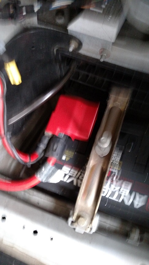

                              A stock BMW positive terminal cover (Part 61218375653) fits perfectly with AntiGravity. The negative terminal cover is a generic left hand coming via Amazon.
