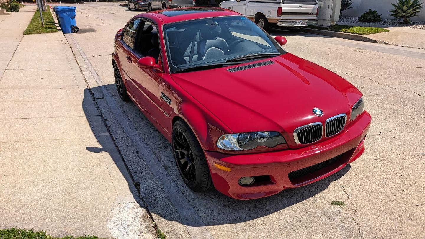

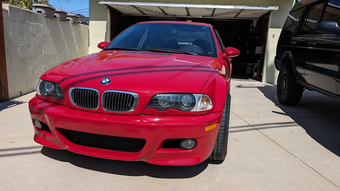

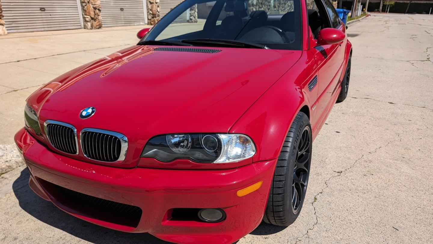

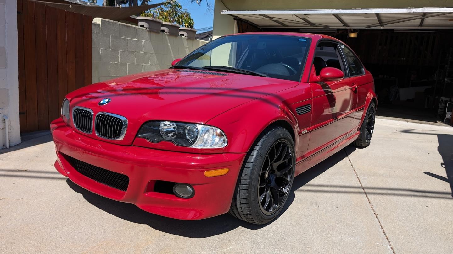

    I recently purchased and installed a set of Satin Black EC-7 18x9.5 ET22 squared with 245/40R18 Mich PS4s on my 04 M3. I'm running stock ride height at the moment but I will probably lower the car eventually. With the stock camber, I'm getting quite a bit of poke on the front. Is this something more negative camber would help with? I've read I can flip the tophats but that seems like it will start eating tires. Or should I switch to a different wheel? I went with the 9.5s in hopes of being able to rotate them but I see the 9.5 ET35s are in stock so maybe that's a better option for the front.
    Thoughts?

    You’ll need around -2.6 to -3° of camber to not have wheel poke with that offset. ET35 is the offset you’ll want if you don’t want to run that much camber.

      9.5et35 is better, also for scrub radius.
      Never heard of et25, usually it's 22, so at least the 25 is a little easier to fit than 22. The other thing working for you is the stretched 245 tire. Usually a 9.5" wants a 265, and you'd then have a even harder time fitting it.
      I wouldn't make any changes yet. I'd install my suspension first, go to at least -2.5 maybe -3 camber (with plates) and go from there.
        ET25 makes the rears flush with fender/body work, but makes fronts poke. For street car, you normally run equivalent of ET35 in front and et22-25 in rear with ET35 wheels and no front spacer but 10-12mm rear spacer.
