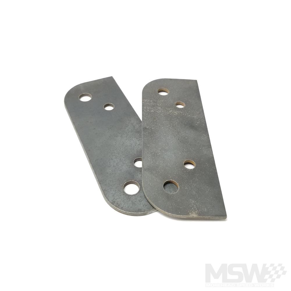

            Ground control front which is infinitely adjustable. I'll never allow any hotchkis products on my cars again after having their front swaybar rip two Mounts out of my ZHP. I finally realized their bushings were clamping down on the bar too much and not allowing it to move freely enough even though it was greased. Glad other love them but I hate them
              That wasn't Hotchkis's fault.
              It's a known issue on this chassis.
              Heavy duty E46 front sway bar reinforcement kit from MSW.  The front sway bar (anti-roll bar) mounts on the E46 chassis are an often overlooked weak point.  Don't let yours fail by not reinforcing them.
                Ground control tore out of mine

                      Side note: If you're running beefy front sway bars, please do yourself a favor an reinforce the mounting points. You might as well reinforce the entire front subframe while you're at it.

                        LOL! God so now I have to take it out!?
                        Just do the reinforcement.
                        2008 Black/Black M5 Sedan
                          I did do the reinforcement, I also don't use the bar as much in the M3 like I do in the ZHP, I let the coilovers do more of the work
