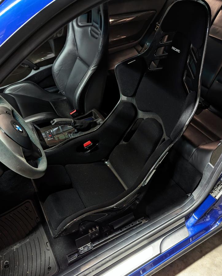

      Aftermarket fixed back seats can get you a couple inches of headroom, but most don't play nicely with the factory 3 point seat belts-- not amazing for a street car. Can avoid by getting specific seats (Cobra Nogaro and Recaro Pole Position ABE are the only ones afaik).

              yea I think the first mod I’m going to do when I get the coupe would be to buy the nogaros or Recaro pp Abe.
                recaro podium is ABE and also FIA certified. doesnt technically matter for street cars in the US but official certifications are better than no certifications
