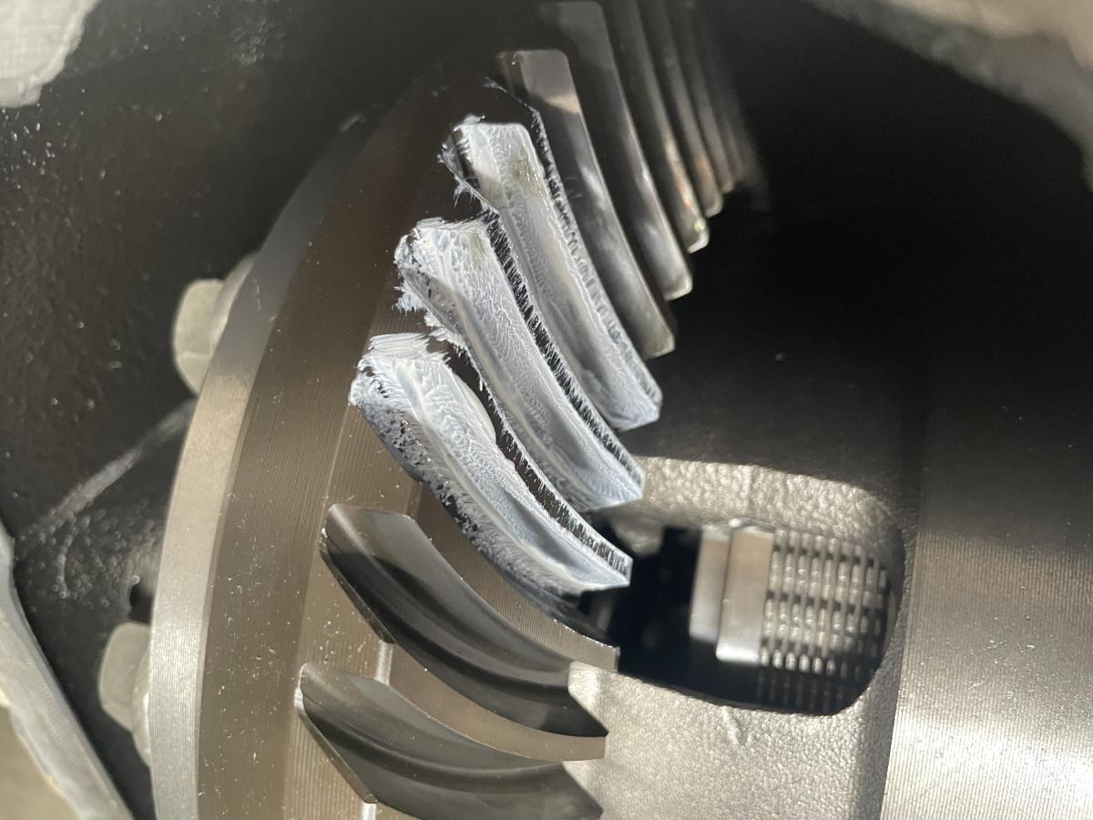

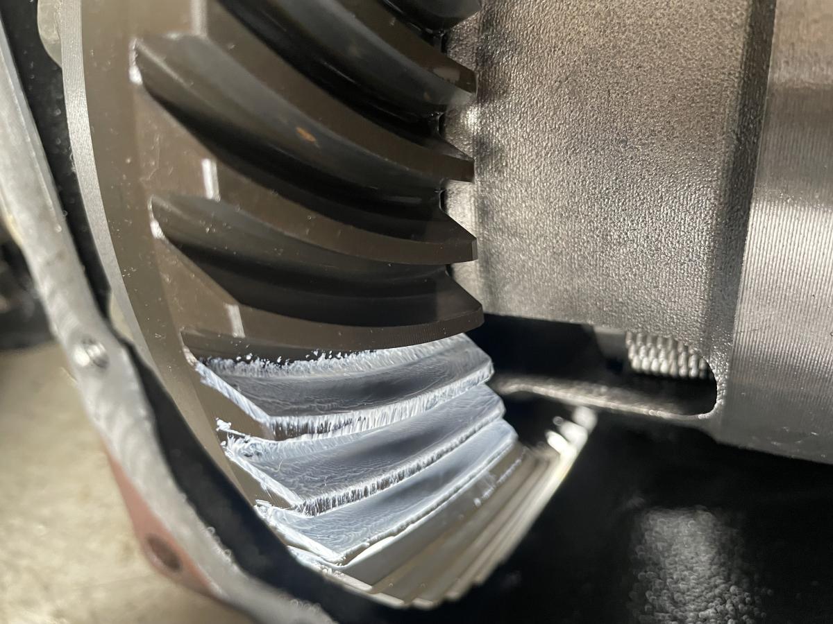

        Lastly, after reviewing my many photos of the gear pattern, seems it was best with the OE pinion shim, although it looked a bit high on the tooth, it also had the best contact area, so I will remove the 0.1mm shim I added to the pinion and roll with the original shim thickness only and aim for 0.1 - 0.12 backlash.
        As for the shorter gears... well yes, it is very much noticeable and the car does feel way peppier, all gears remain very usable including 1st gear. In 2nd gear it can flash the traction control light as it wants to spin the tires a bit. On the road the car does feel stronger and no longer needs a downshift going uphill. The car is a bit busier at 75mph and you have now 3.4k rpms v 3k on the stock gearing. 400rpm is not much, but it is something that can annoy others, particularly with loud exhausts, I will say this, a 3.91 would be a mid point as it is 8% shorter so it is 80% of the 4.1 with a bit more flexibility for highway users. I personally don't bother it, and I love the feel of large engine in a small car it gives. and with the CSL airbox, the experience is just awesome! What it is refraining me from full happiness is the whine, but I think it will be fine once I fixed the setup with the correct backlash
        Final setup (with 0.1mm shim under the pinion bearing)

        This is the contact patch with just the OE shim

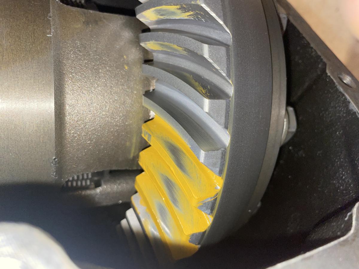

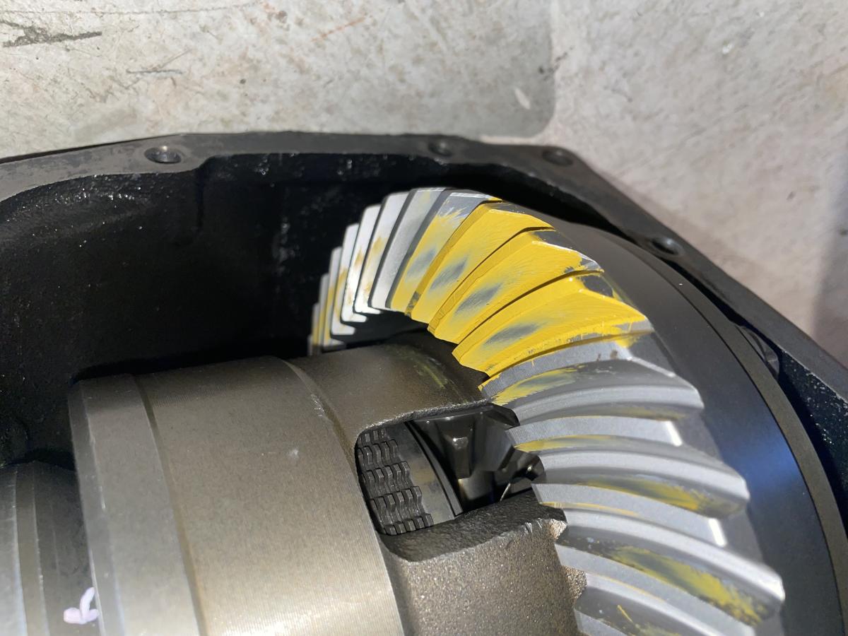

            Here is another data point. This is what I measured in my original diff, this has 90k kms or 55k miles. 100% stock and original to the car.

                    For reference this is how the original diff reads

                      Doesn't real gear marking compound work a lot better?
                      I learned the same lesson.
                        it does, and surely would of saved me from reopening the diff lol.
