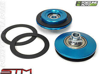

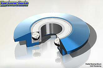

        That's the spring rates I currently have and I really like the way it rides. I originally had 11/16 kg springs and it was way too stiff. The spring noise sounds like what I experienced with my KW's, The radial bearings in the Fortunes solved this problem and I get NO noise from the front coilovers.
