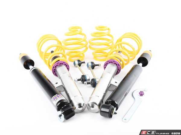

    BC racing coilovers with swift springs or KW V2s?
    Mostly road usage with aurocross/track day 1/2 timee a season.
    Not a daily 5/6k miles yearly.
    Any info helps.
    Thanks

          I have KW v2s, no complaints. Fairly comfortable setup and good for mild track use as it's on the softer side. I'll be upgrading to ohlins in the near future if you're interested in a used set. Let me know.

                        I got V3's and im not super siked about them,got a killller deal at the time so couldnt resist. Mybuddy has a set of Ohlins on his e46, those are fantastic!
