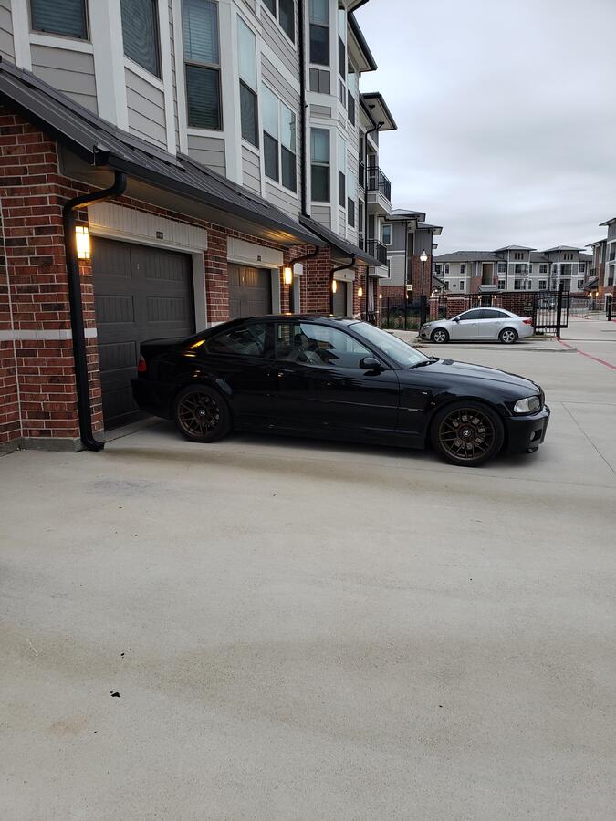

      Do you care about ride height/ wheel gap? My brother installed dinan springs/koni yellow's before I bought the car. It rides pretty nice, but imo it looks a little too high with arc 8s. I'm going to look at KWs or something adjustable eventually to lower it a bit.
      Idk if I have an accurate photo to include but I'll try.

        Thanks for those pictures. I care about it somewhat, but don't want to be worrying about scraping on every raised surface I encounter. However, from your pictures, it looks like ~0.5" lower than the Dinan springs would still be fine. Might have to look into other springs.

                  The front looks fine, it's the rear that looks like it could be a little lower. I'll get some better photos. I can look to see if the end links are stock if that helps any?

                      After doing some more research I think I'm going to go with the Dinans, but more pictures won't hurt! And thanks, confirmation for the end links would be great, although I might just swap them out anyway to get fresh new units in there.

                            Dinan springs/ koni yellows. 2 fingers barely fit in the front as shown in the photo, 2 fingers easily in the rear. It was 90 degrees today so I didn't jack the car up to check out the end links. I took a photo of a rear one.

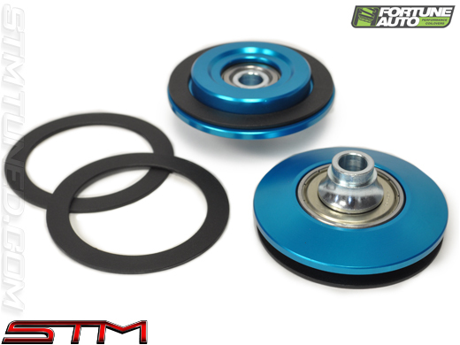

                                I have GC Coilovers right now and was looking at the Fortune Auto 500 coilover setup with 9/11kg springs according to them. My issue is I getting a sound that sounds like springs rotating from the front after replacing the front shocks from GC 3 times! Just annoyed they couldnt send me the correct shocks three times in a row so i want to move over to a company that i can easily source the right parts from. Its is between KW V3's and Fortune 500's at the moment.
                                That's the spring rates I currently have and I really like the way it rides. I originally had 11/16 kg springs and it was way too stiff. The spring noise sounds like what I experienced with my KW's, The radial bearings in the Fortunes solved this problem and I get NO noise from the front coilovers.
