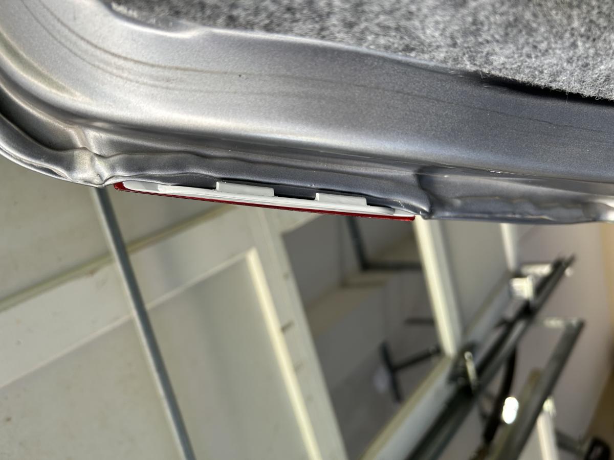

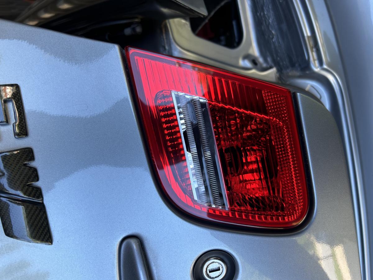

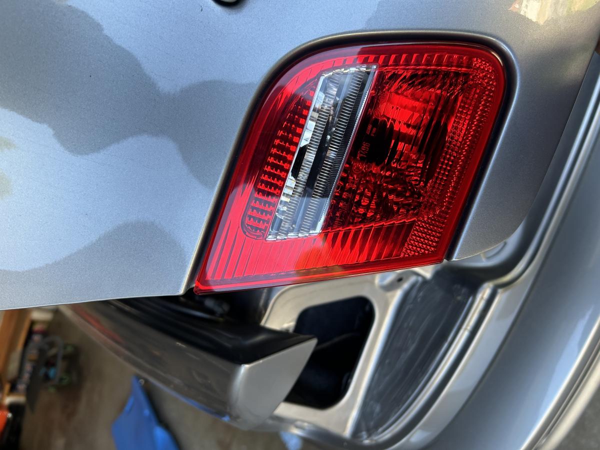

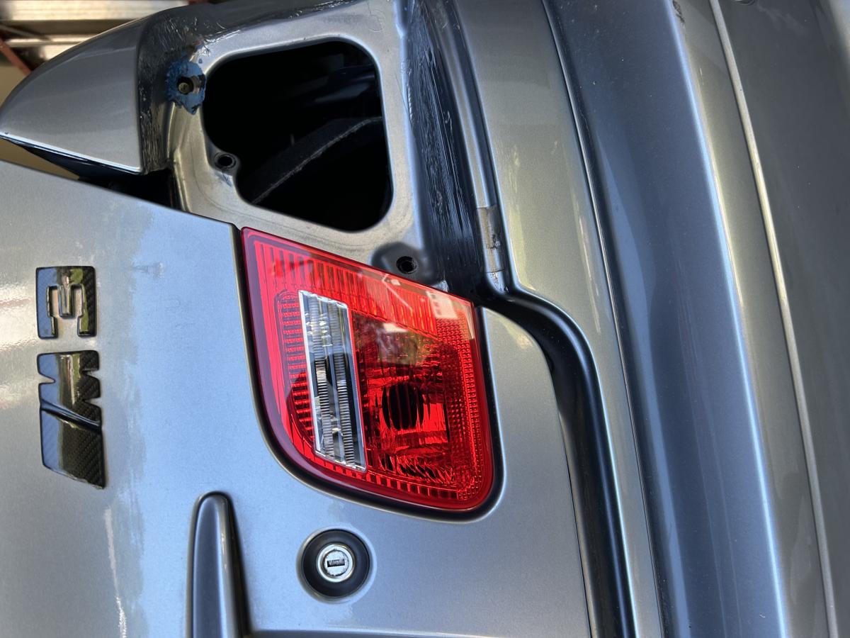

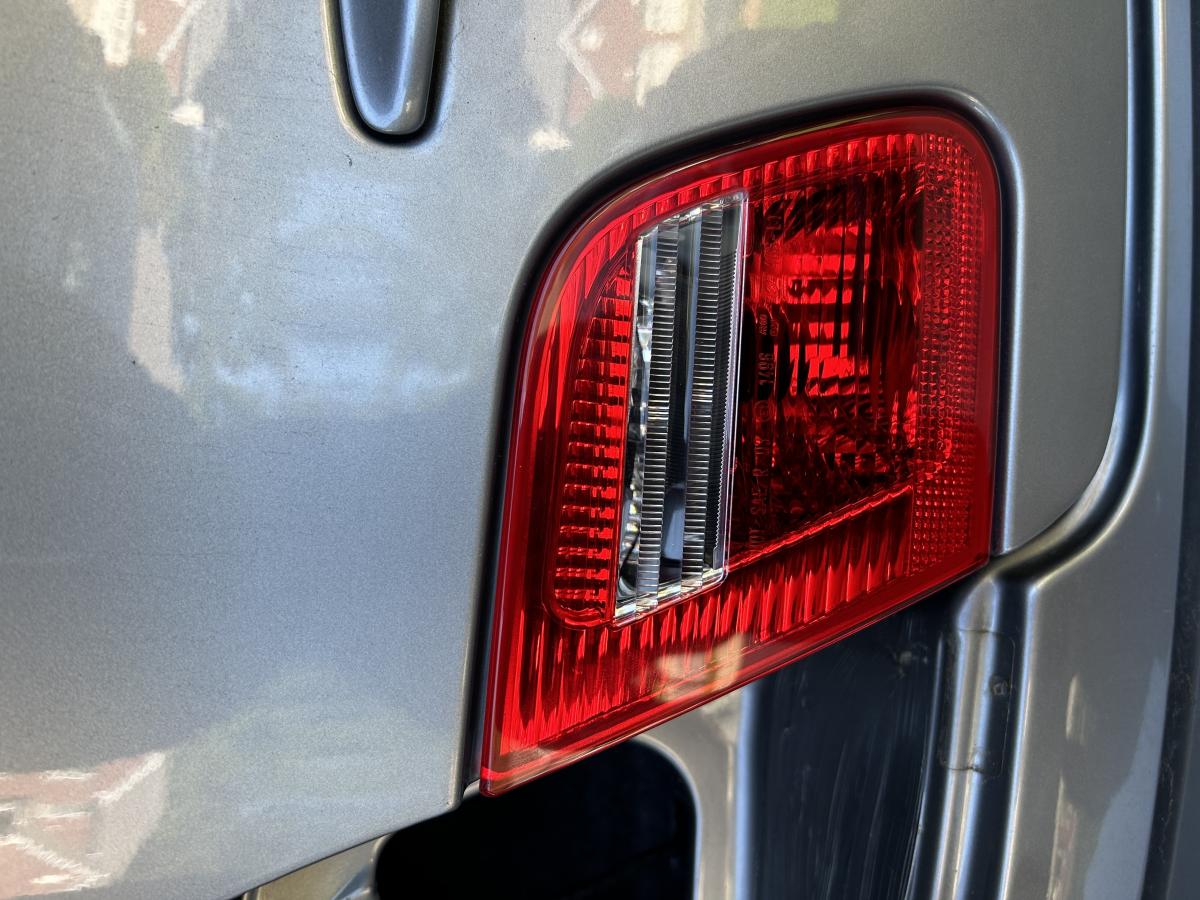

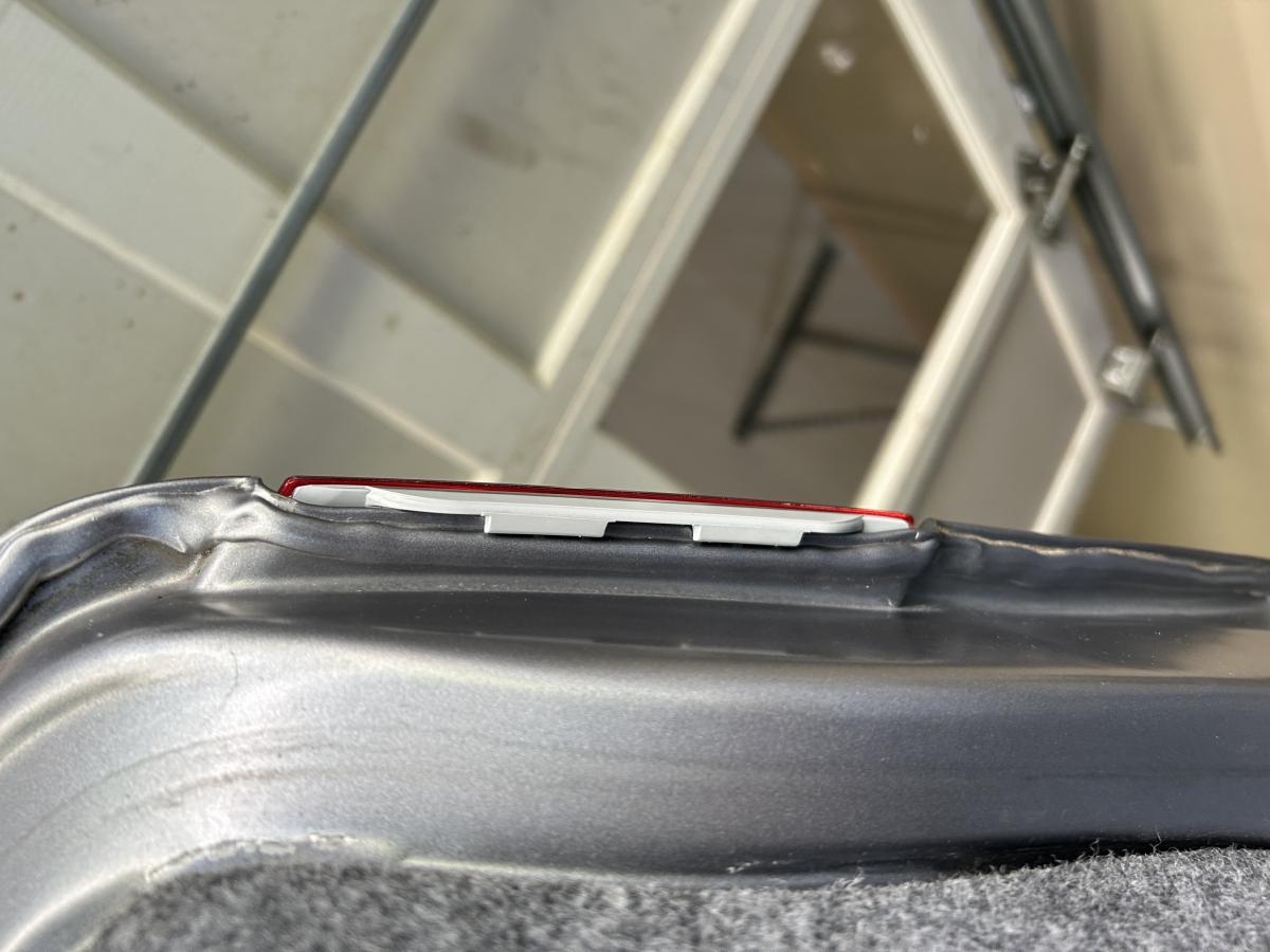

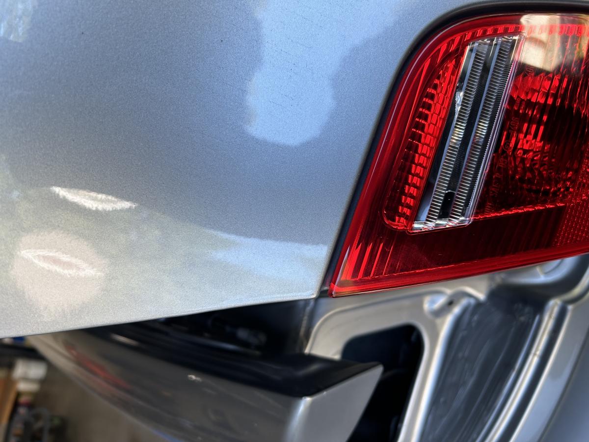

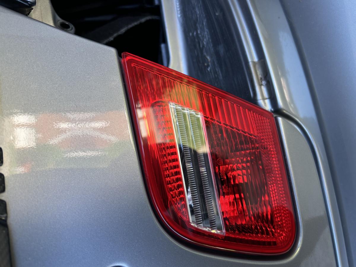

                        PSA: I just replaced using ULO and fitment was pretty bad on driver side. Ordered a replacement, same thing. Upon closer inspection with trunk raised, you can see how uniform passenger side is vs driver side.
                        I’m tired of sending stuff back and forth to FCP euro. Just thought I’d report. I would just spend the money and go OE if I could do it over again. I’ve spent that amount already on shipping plus these shitty ULO’s.
