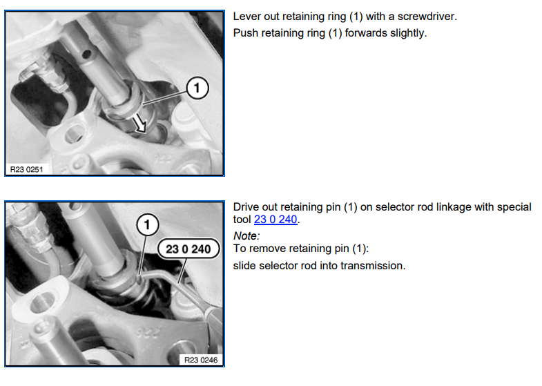

                          Alright so today I got to the transmission (removed exhaust, driveshaft, and all the stuff under the hood - fan, fan shroud,....). I'm following the steps from ISTA+ (TIS?)
                          Now I'm blocked at removing the pin from the gear selection rod (in order to remove the gear selector rod and SMG actuator from the back of the trans). There's a C-clip you have to push forward: that's done. The next step is to "drive out retaining pin on selector rod linkage with special tool 23 0 240." I can't get that pin out though, I think I've pushed on it hard enough from the passenger side of the hole. Any advice?
                          Also, the documentation that I'm following advises removing the intake manifold. I understand that the work done under the hood is to tilt the engine and transmission to access the top screws on the bell housing. It "feels" like this should be achievable with the intake manifold on. What are the "gotchas"?

                            I think I remember sticking a small screw driver into the hole on the rod (on the selector rod) and twisting one way or the other against the spring inside the transmission (I think to the left like going into reverse) and that releases the tension on the pin.
                              This is a great idea to release the pin. Actually the spring is inside the actuator and not inside the tranny, so try to rotate the actuator shaft instead.
