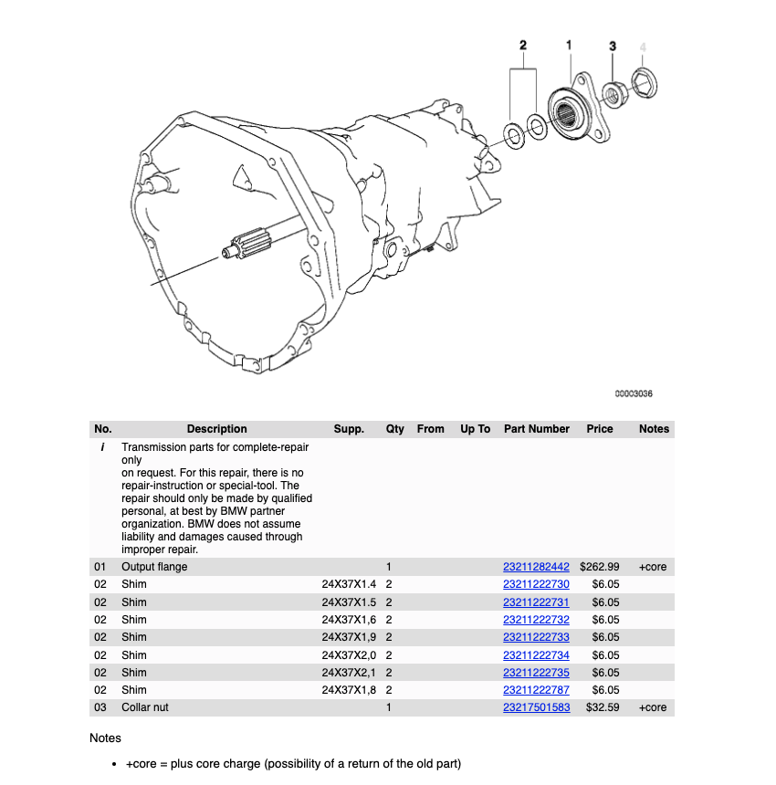

      What's up with part 4 in this diagram? I don't think there was one when I removed the output flange, but TIS says to install this and RealOEM shows it grayed out. Just being on the safe side asking.

        #63
        Originally posted by E46m3zcp View Post
        What's up with part 4 in this diagram? I don't think there was one when I removed the output flange, but TIS says to install this and RealOEM shows it grayed out.​
        Interesting that the diagram shows part 4 aftr the big nut. If used it should be under the nut and functions as a lock. Is the nut some kind of Nylock?
          #64
          No it's not a self-locking and neither TIS nor the Bentley mentions replacing the nut.

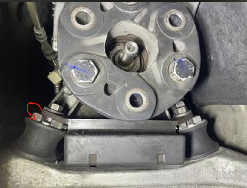

            Can someone confirm the proper installation of the vibration absorber on the cross-member (my bad here, forgot to document on disassembly) ?
            Does the vibration absorber stack on top of the transmission (as in the image - transmission, vibration dampener, nut) or is it the opposite (vibration dampener, transmission, nut)?
            In other words, should the nut contact the vibration absorber (like in the image) or should it contact the transmission's bracket?

              #66
              Looks correct in the image and the damper stacks on top. Here is a video for reference - https://www.youtube.com/watch?v=NmEOFBqreX8
                #67
                Does the vibration absorber stack on top of the transmission (as in the image - transmission, vibration dampener, nut) or is it the opposite (vibration dampener, transmission, nut)?​
                No, the rubber damper should be under the tranny. There is no space to mount the rubber on top even if you try.
                  #68
                  My wording "on top of the transmission" is confusing. I meant the transmission mounting bracket (the silver part between the rubber thing and the mounts in the photo belongs to the transmission assembly).
                  The question was: is it bottom-up: cross-member, mounts, tranny, vibration absorber OR cross-member, mounts, vibration absorber, tranny?
                  Thanks for confirming that the photo shows it properly mounted.

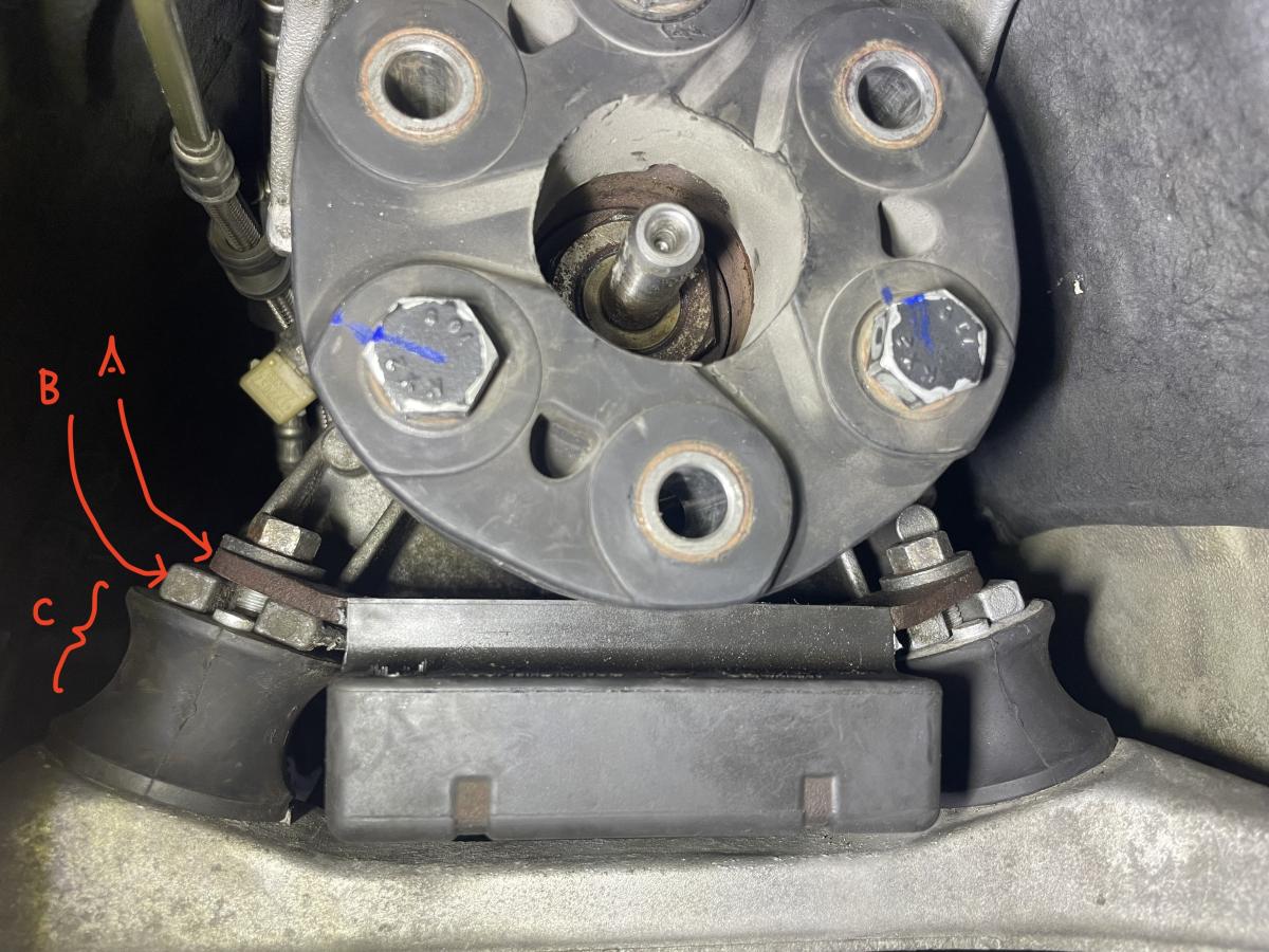

                    #69
                    Everything in the pic looks like silver or gold.
                    I still have to idea -- the tranny mounting bracket? what bracket? Is it the cross bar, or the tranny mounting foot? You better highlight the parts with A, B, C, ....so we understand.
                      #70
                      Ok, here is an annotated version. My question was if B goes on top of A, or vice versa. I'm calling B "silver" an "the transmission bracket" because this is what secures the transmission to the cross member assembly.

                        #71
                        Click image for larger version Name:	IMG_6106.jpg Views:	0 Size:	158.6 KB ID:	269108
                        B should be on top of C.
