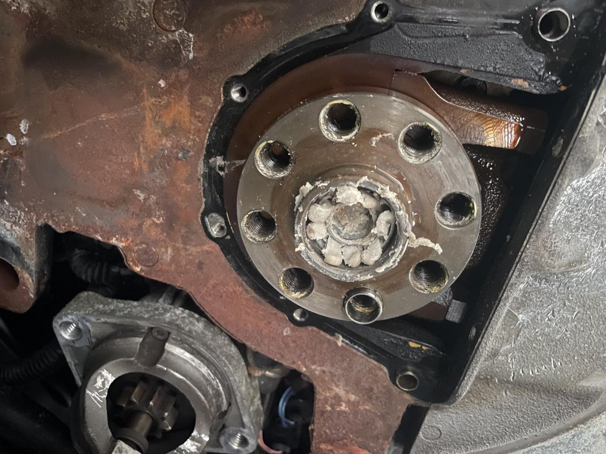

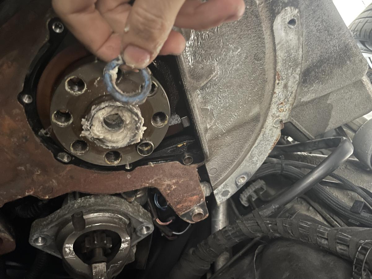

    Well the bread trick isn’t working for me. Pilot bearing’s blue “cap” broke and the bread is coming out through the bearing. I tried for about 1h and it won’t budge. What do people use for this?
    Click image for larger version Name:	IMG_6003.jpg Views:	0 Size:	167.3 KB ID:	267467
    Click image for larger version Name:	IMG_5998.jpg Views:	0 Size:	139.3 KB ID:	267468
    Thinking of using J-B weld to glue a washer to the front, blocking the bread from coming out. Is this a bad idea? (taking care not to glue the sides of the bearing in)

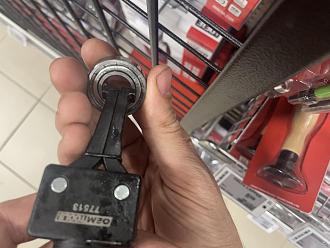

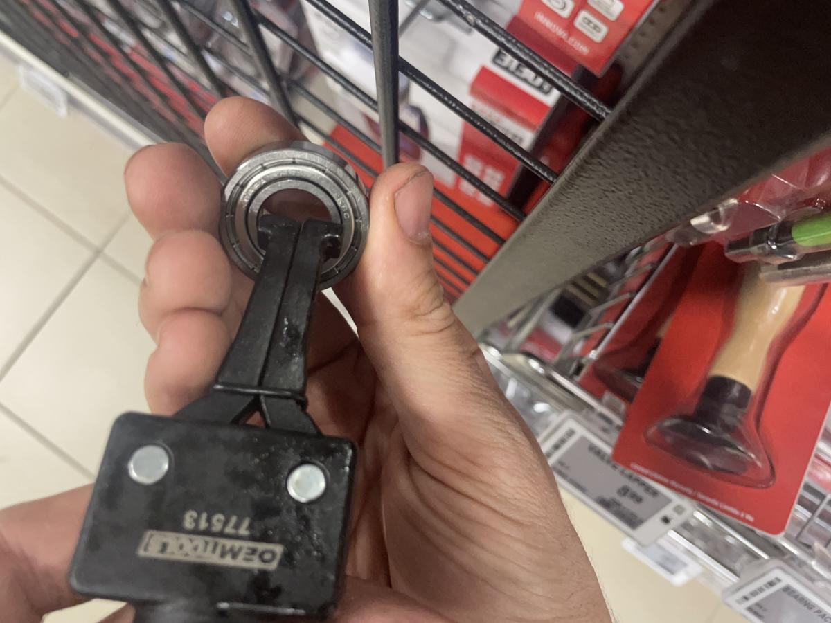

      This tool does not fit. Hopefully this can save someone a visit to the store
        That's unfortunate. Maybe it could work with some modification to the hooks. Otherwise, the other option is the slide hammer - Link . The genuine tool was 250 and seems to be NLA - Link .

          I finally got it out with the bread. Yesterday I was making the bread too wet, and it allowed it to come out through the sides for being too wet. The trick today was not add moisture to it, just push it in as it is from the bag

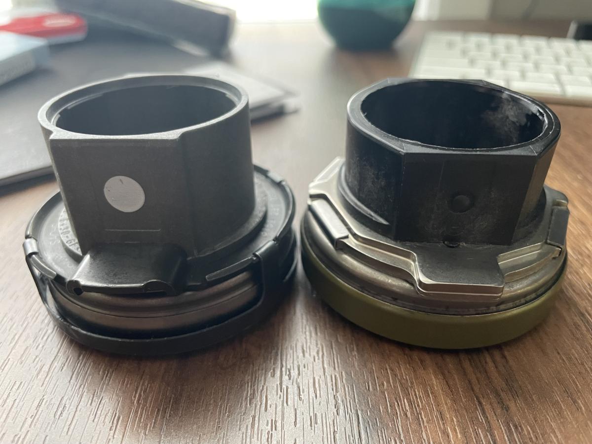

                    I also got a Sachs TOB but it looks different than the one that was installed on the transmission, I’ll try posting a photo later

                      left is Sachs, right is the one which came in the Luk kit (INA). The metal part that contacts the pressure plate is loose.
                      Click image for larger version  Name:	IMG_6044.jpg Views:	0 Size:	118.1 KB ID:	267632
                        #56
                        I think you're talking about the bearing thrust axial plays, which is fine because the bearing is under a slightly preload so it's not loose any more when installed with slave rod pushing on the fork.
                          #57
                          I don’t think it’s axial play. The top of the bearing isn’t clamped. What you said about preload still applies.

                            I've replaced more BMW TOBs than I have LuK TOBs, actually I have not replaced any LuK for that matter.
