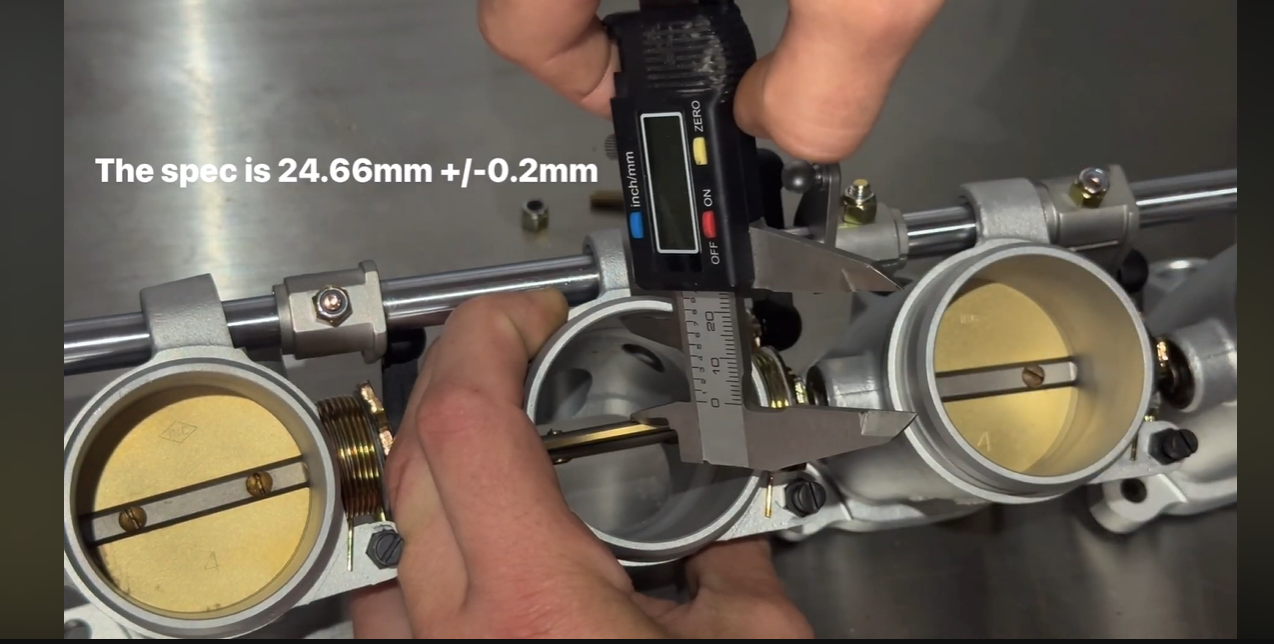

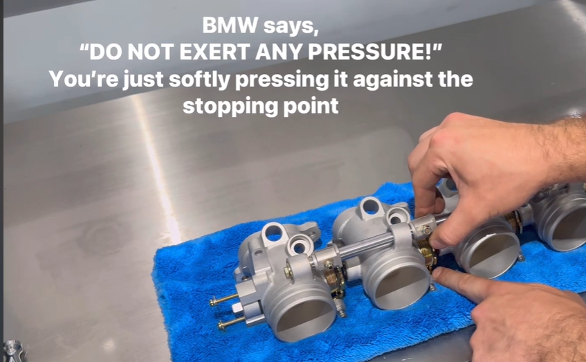

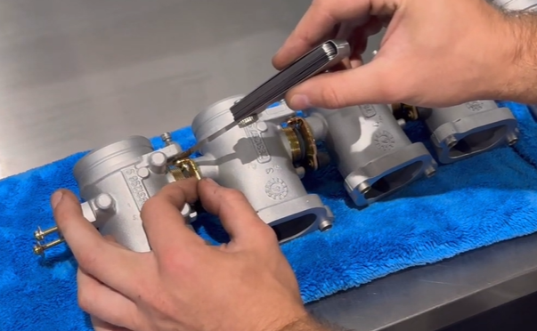

                            Not the TIS but this is something I have bookmarked.

                              I pulled my throttle bodies and sent them out for vapor honing and bearing replacement. #3 was sticking badly - based on the video the shop sent. It was sticking near/at idle which aligns with the timing of my EML codes. Based on the demonstration, it was binding enough to complicate returning to idle.
                              The operating rod has a lot of corrosion, I assumed it was superficial.
                              I'm going to work my way through this, and ensure the throttles are mechanically sound.
