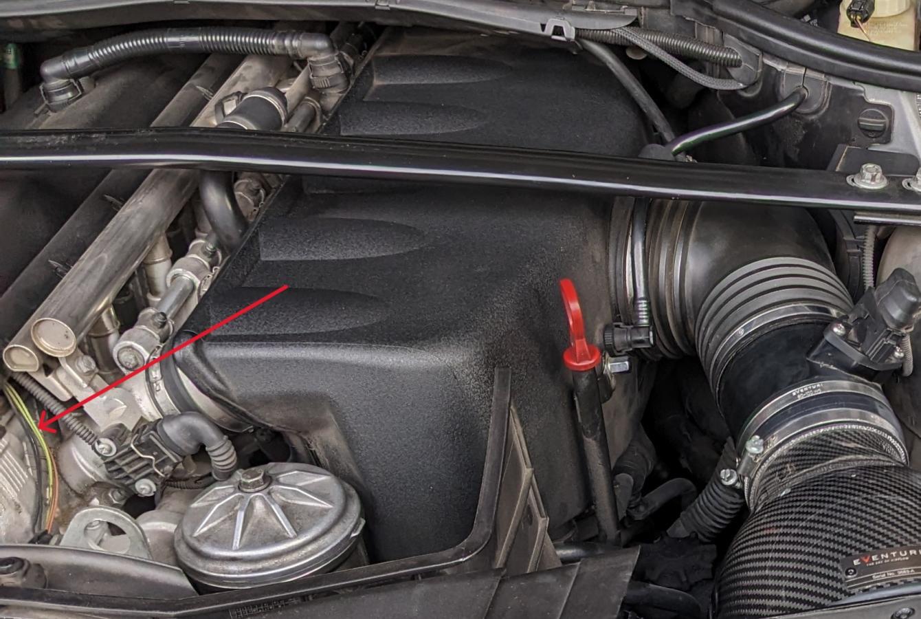

    Hello,
    The corrugated tube that i have seen on other S54's was missing on my car. (what exactly are these wires controlling)
Name:	PXL_20230213_002207549 Wires.jpg

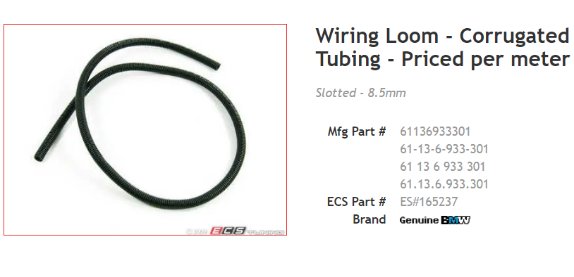

    I found 2 corrugated tube sizes on Real OEM, not really specific to this location so i bought the smallest size (8.5)
    I'm not sure if it was the correctly way to fix the missing tube issue, but I didn't like the exposed wires.
    I trimmed the tube to size and when I tried to use the existing tube holder it snapped its probably due to age and it didnt take that much force to break it.
    I cant seem to find the holder clip on real oem to find the part number. I used zip tie for now.
    Anyone know if i used the correct tube, and where i can find a replacement clip.

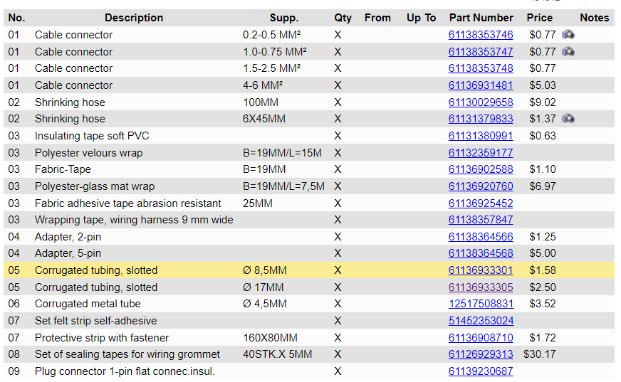

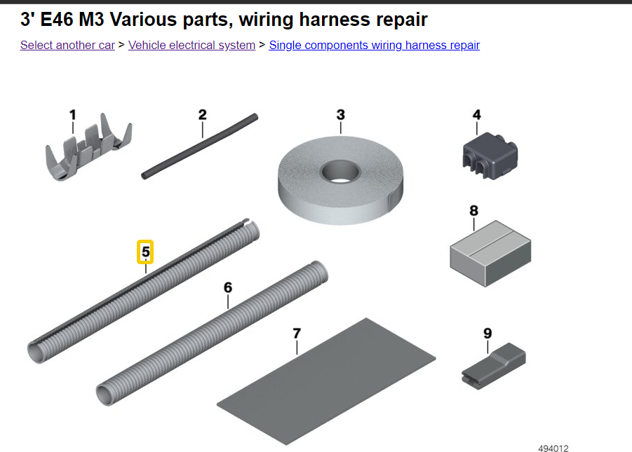

        Real OEM calls these corrugated tubes #5 below

            i used the same tubing to replace that portion of wiring loom on my car as well (btw that section of the harness connects to the vanos solenoid.) pretty common for the original tubing to fall apart at this age.

                        As mentioned, those wires go to the vanos.
